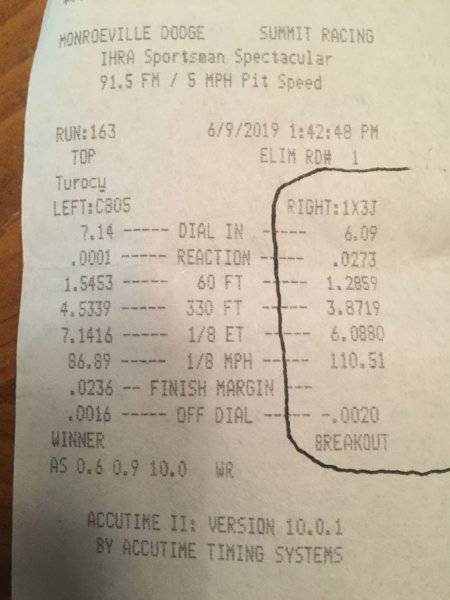

Racing, joking, laughing, and a few adult beverages with Friends watching the final rounds. IHRA officials and the employees of Keystone Raceway Park did a GREAT job. Track prep was excellent all weekend long. (Thanks guys) With the way my Duster handled last time out I wasn't sure if I was staying one hour, one day, or one weekend. I dug out my chassis books (4) and did lots of reading and gave a call to my buddy Tim Bowman to double check the direction I was heading just to be sure and was rewarded with a car that calmly left the line and repeated all weekend long. 2 days, 7 passes, and both lanes 60 foots were 1.279-1.292 and the car stayed 6.082-6.114 on a sometimes windy, gusty weekend. No more long weekends without my motorhome and cpap for me. I was running on almost zero sleep yesterday. My buddy whooped on me bad 1st round yesterday. Check out his pass in the left lane
