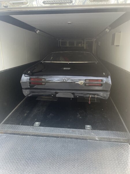

And no side door. I couldn't.Well the good news is that at 68, fat, out of shape, and ugly I can still drive it into the trailer and climb out the window.

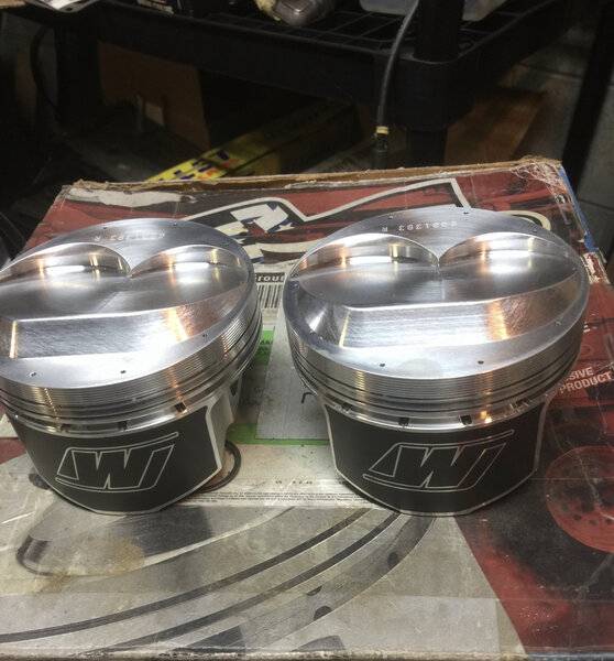

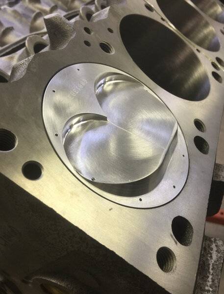

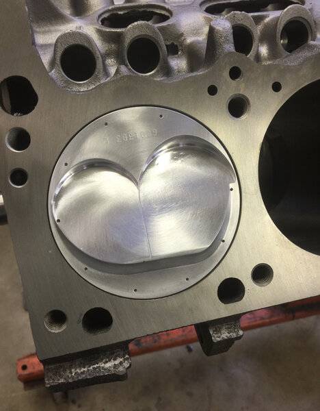

High compression domed Wiseco pistons
