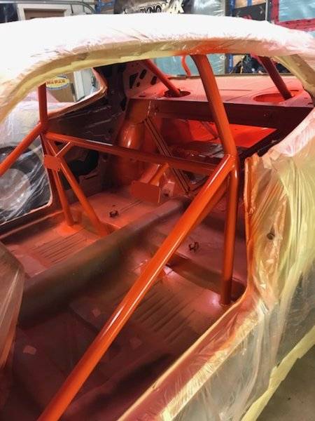

First Nitrous pass, and need rollcage/rollbar
That looks really good! Did you do that yourself?
The bar is an S&W kit. Installed by me and my fab friend that has a shop. It was a pain in the *** to keep that front bench seat. Had to narrow it on each side. interior was installed in my carport LOL.
S&W cage here also.Installed myself.Was a pain but it's done now.
