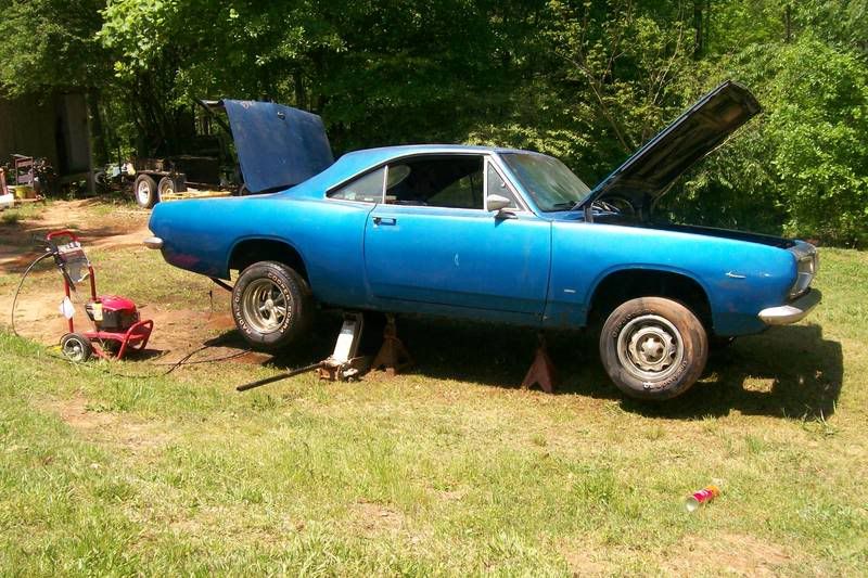

I jacked the other side of the car up this afternoon and did some more pressure washing. I'm gonna have to let the ground dry some before I do any more. It made a hell of a difference though. Even took a bunch of undercoating off in spots, so that'll save me some scraping. I'm gonna try to convince myself to start cutting out the rusted spots of the floor in the next few days. A rotisserie would sure be nice right now......

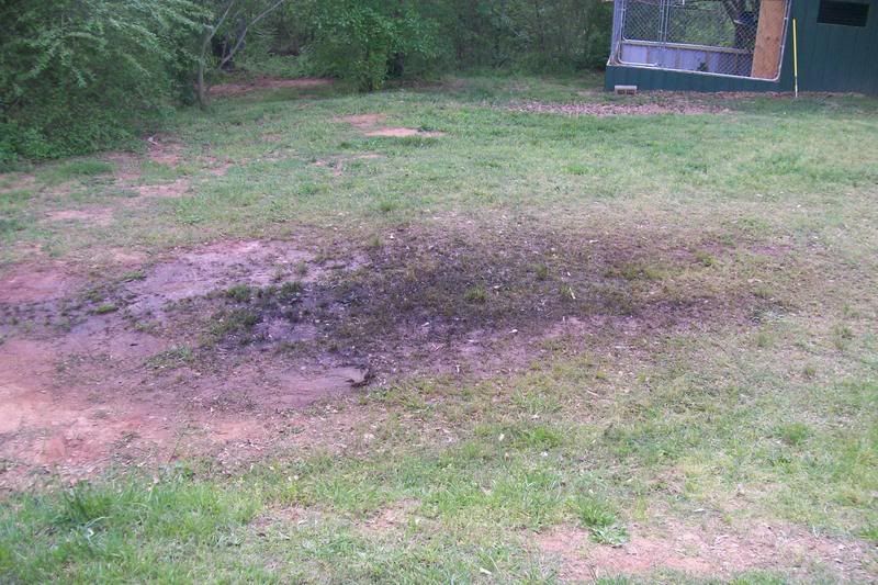

Here's a pic from where the car was sitting today. I'd say I got a little grime off the bottom of it.

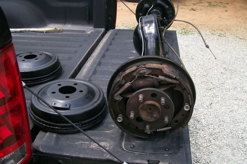

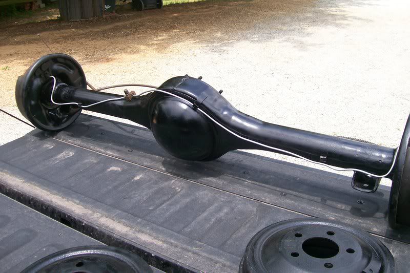

I left my house this morning a little after 5:00am. 8 hours and 438 miles later, I'm back home, with an 8 3/4 rear for my fish. $75 in gas, and $350 for the rear. Big bolt pattern, 11 x 2.5 drums. It's a C-body set-up that's been narrowed to A-body specs. Maybe not the best price in the world, but it was a lot cheaper than most that I've seen for sale lately. I've got an E-body rear that I'll be using the pig from, 489 case with either 323's or 355's, I can't remember which. Now I just need to find some shock plates and u bolts.

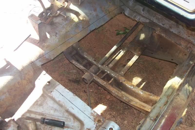

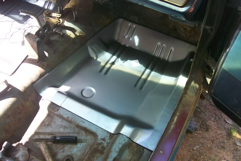

I went by YearOne today since I was in the neighborhood. Got all 4 floor pans for my notch. $371.00. They seem to be pretty good, I just wish they made a bigger replacement pan that would cover the spot under the front seats. Being the impatient person I am, I went ahead and cut out the passenger side front floor this afternoon. I need to do some more cleaning, and clean up inside the frame rails and paint inside them. Then I'll weld the pan in. I'm gonna leave the pan where it overlaps the old floor, plug weld all the way around it, then weld the seams solid. More pics later.
The front of the new pans have a lip that turns down. It's made to meet with the lip from the firewall. I'm just gonna beat the lip out flat so that it sits on top of the current floor. I really don't want to get into trying to cut out that part and do it the way the factory did it. Anyone see a problem with my way?
