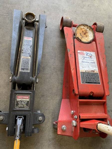

I've had the Craftsman 3 ton floor jack pictured on the left for 19 years. It's always worked fine, raised anything I needed it to raise. However, I've never liked how the handle isn't fixed to the jack. It's always a pain in the neck to keep it inserted, so I went on the hunt for a more traditional jack with a fixed handle.
I found the MAC Tools 2-1/2 ton jack, and right away I noticed the obvious size difference. Now, engineers aren't stupid, so I know some thought went into each design. My question for the experts is, do they determine the lifting capacity simply by what the actual hydraulic mechanism is rated for, or is there also the factor of the design of the jack? The MAC Tools jack looks more stout and stable, but I guess if the hydraulic part can only lift so much, it's a moot point.

The Craftsman isn't even technically a floor jack. It's called a trolley jack. Very light duty. If you're not dead yet, consider yourself lucky.

Look at that MAC jack, it's a wider base, and smoother action with less strain while pumping, and probably lifts the load higher.
You can shift or even roll the MAC jack with the car on it, the Craftsman will def flip over on you.

As far as I know both the hydraulics and the jack frame integrity are tested. There is a lot of liability with lifting equipment and there is some design overkill built in. Look at the two jacks and tell me which one you would trust. And yes, I have owned a MAC jack like the one pictured. I have 2 actually. A low lift and a 3 1/2 ton. I used it servicing my tool truck. It weighed 16,000#

Every morning I wake up, I consider myself lucky. I get what you're saying though, I mean it even LOOKS light duty compared to the MAC.
100% agree - the MAC jack has a nice, wide base. In fact, everything about it is more stout than the Craftsman. The handle is almost twice as long for more leverage, nice big beefy wheels. So, I guess the deal here is less about lifting capacity and more about a nice, stable platform and better design overall.

I trust them equally. As far as tonnage goes, if she wont lift it up, we gonna need a bigger jack
I'm gonna keep the Craftsman around for those times I need 2 jacks, but I think I'll be using the MAC as my primary from now on.
