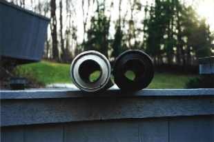

The non Formula S '65 cars with the Commando 273 were called rallye pack cars. I have seen them without the swaybar etc. Non formula S cars,and Valiants didn't have a bright trim on the resonator-it was black on the one's I saw. Gib
I think that was soot from running rich. :toothy7:
I've never seen one that wasn't "chrome".
I've seen the black resonators and the chrome ones. I always thought the black ones were early examples. There's a photo of the Formula S stuff in a pamplet, can't remember which pamplet exactly, but it shows a black resonator.
It might have been pre-production or something. The only one I ever had my hands was from a 67 Rallye Dart we parted out in 1981. I let somebody have the tip, but I can't remember who.

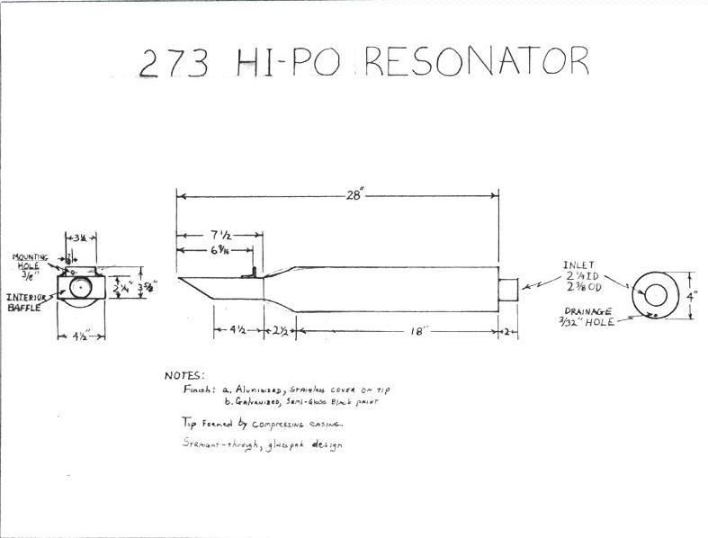

resonators!
And if you want to make your own (that's what I did because the original one I found at Carlisle is just too rare to put on the car) here's how. I've been told by many people the muffler was optional depending on the State. I run with no muffler, just the resonator and it sounds great!
