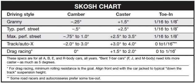

I'm not sure I heard anybody mention spit and toilet paper. I'd be happy to take it to a "shop" if I KNEW if I had a GUARANTEE that the guy behind the curtain knew WTF he is doing. In many cases they do not. There's been many posts from guys on HERE who got screwed "at a shop," and who were refused the special attention and specs these old girls require.
Thanks man. That's the one I need. I agree about the shops not knowing **** about the old cars. I live about 80 miles north of firm feel. I may just drag it down there and have them align it.

The problem with those nice new machines is the specs they have programmed into them for our old junk. And then on top of that the RANGE of those specs is retarded. Most of those guys just hook up that machine and adjust until everything is in the green, tighten everything back up and move to the next car. Give them the specs YOU want and request a printout when done or go somewhere else.
You can program in whatever specs you want. It has the factory specs of course, but you can type in whatever you want.
