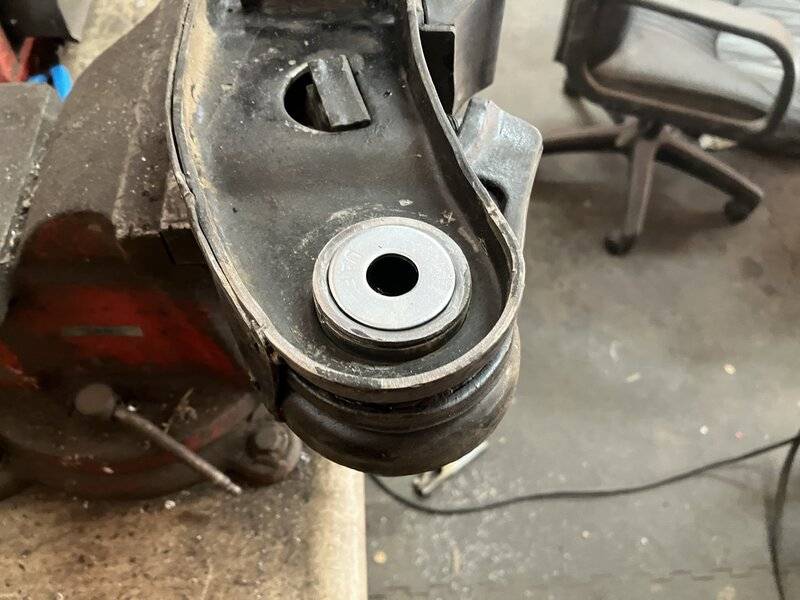

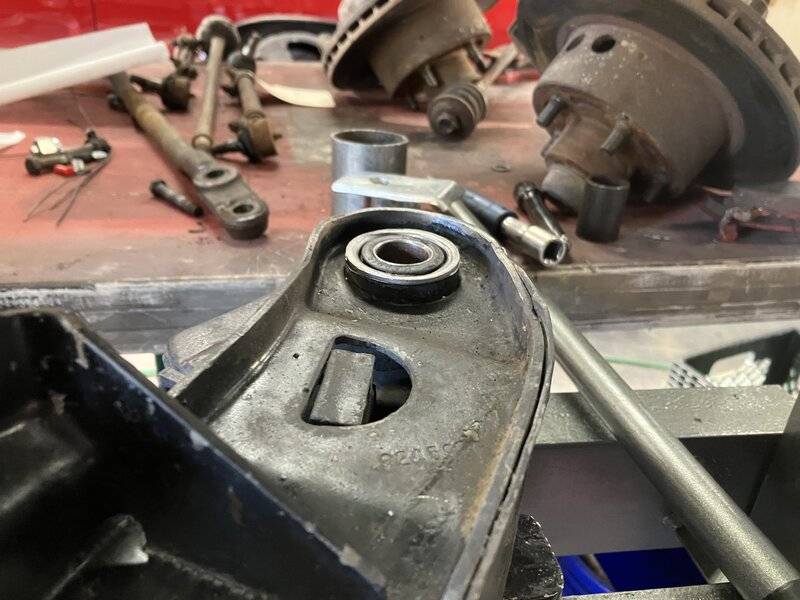

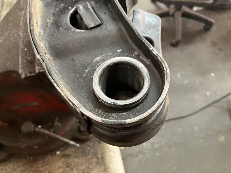

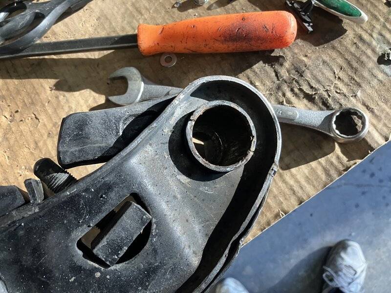

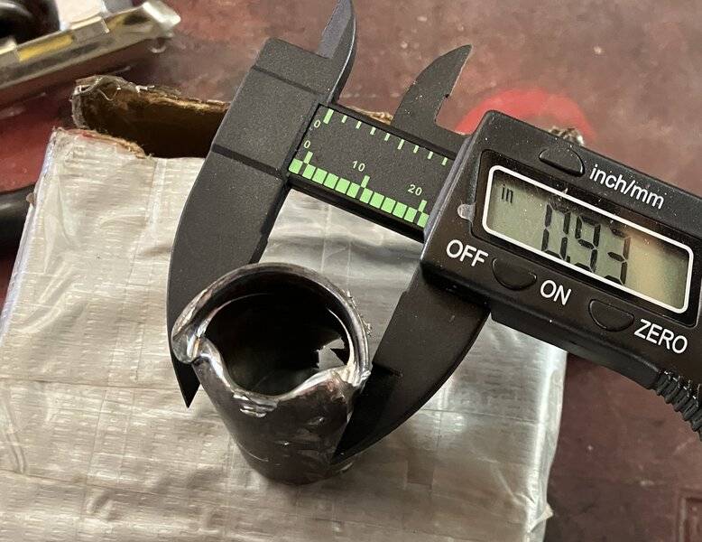

There are a few ways to remove that shell. Some will smash and chisel the end and pry on it until it pops out.
If you have one of THESE though…

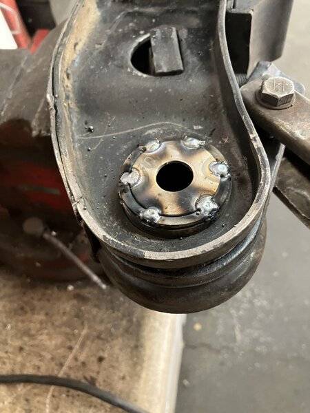

Just clean the edge of the bearing shell.

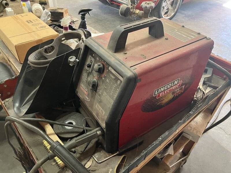

Weld a washer to the edge.
Now you have a surface to press against from the back side to drive it out.
Next, the pocket is cleaned up a bit.
Just press the bushing in.

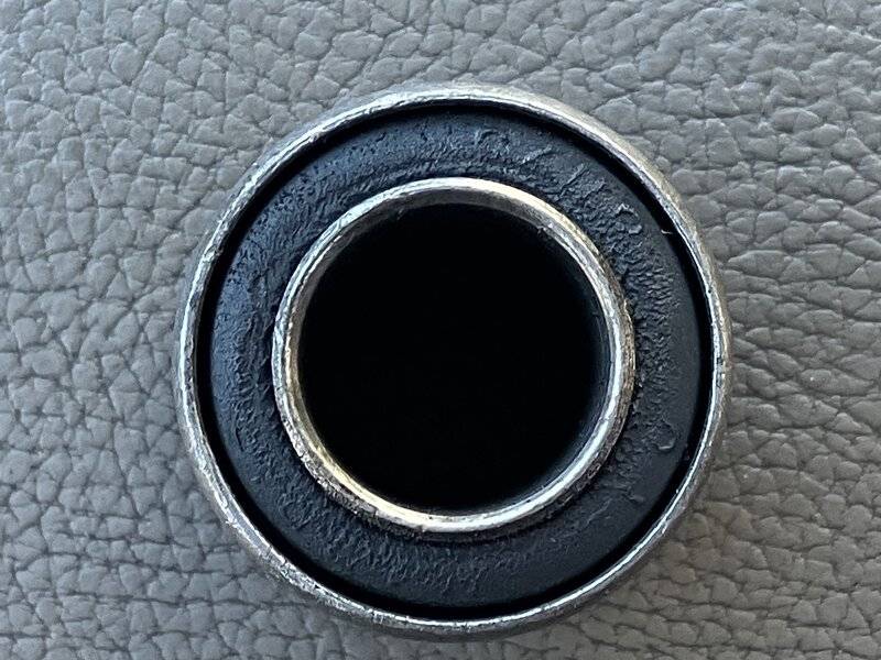

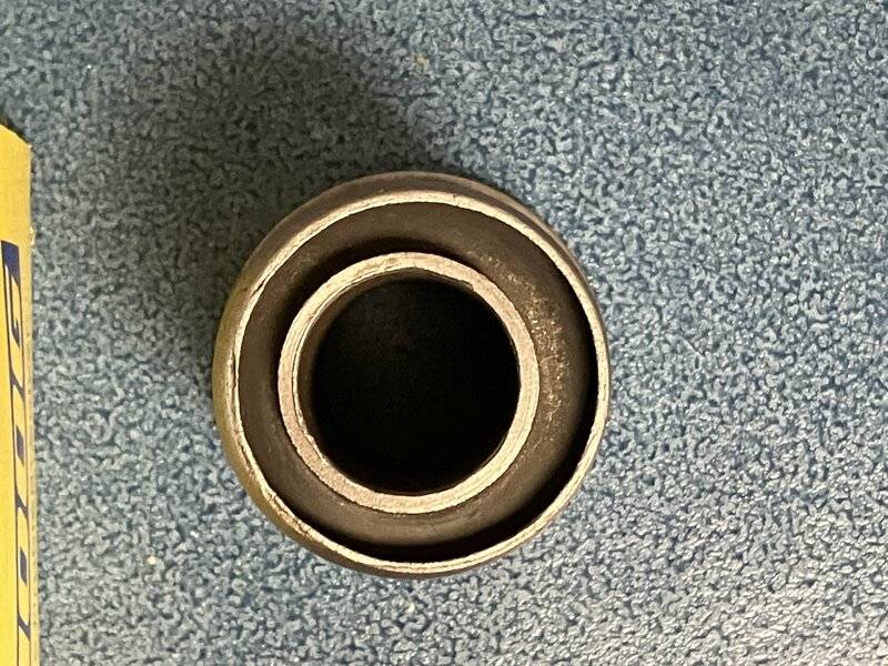

Take a closer look.
Offset lower control arm bushing???
This piece of crap was way off center. Once installed, it might line up but it would probably distort…the thin side would then have a gap and the thicker side would be squeezed.
OR it would result in more negative or more positive camber.
What junk!

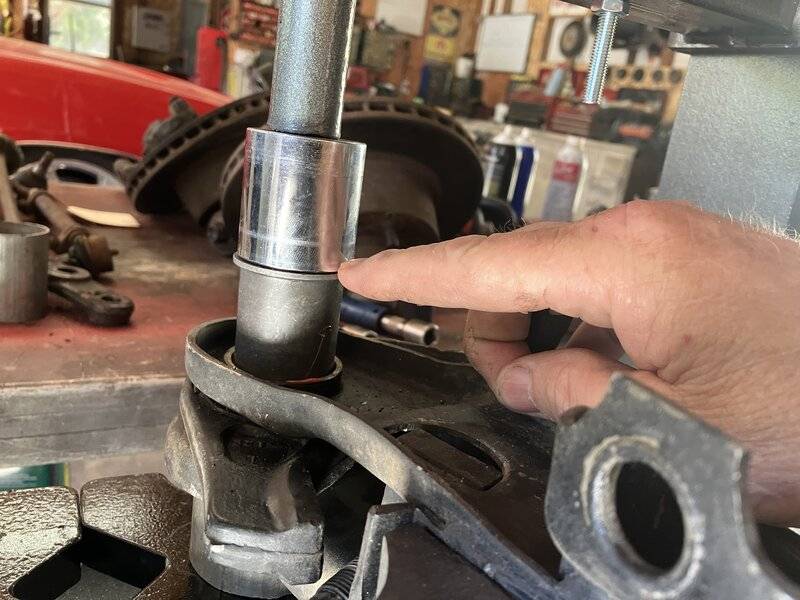

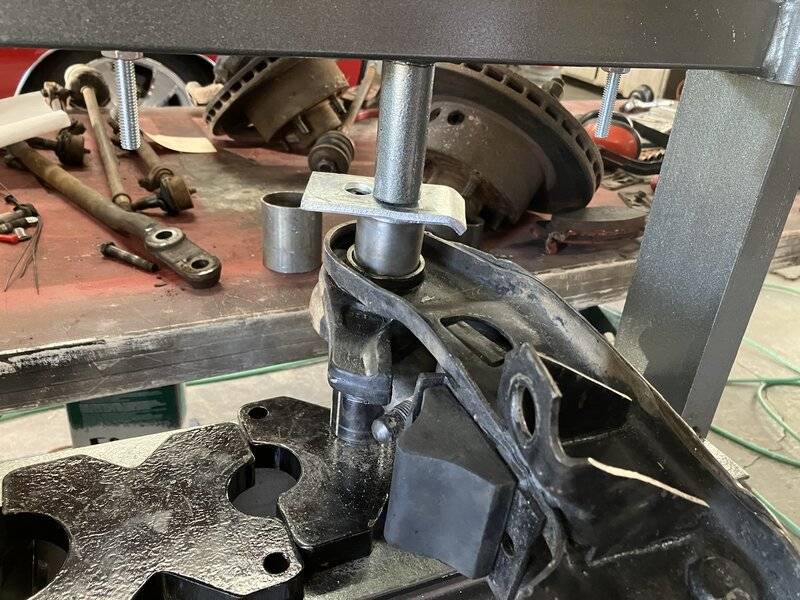

Pressing the new bushing in is easy.
You just support the LCA so it is square and level using spacers, hollow sections of pipe, whatever you have. Make it safe though. When you apply pressure, the force of the press can spit your spacers out if they aren’t placed properly.
The bushing has that lip at the top. I used a Craftsman 1 1/4” socket.
Press until the lip of the bushing shell meets the pocket and sits even.

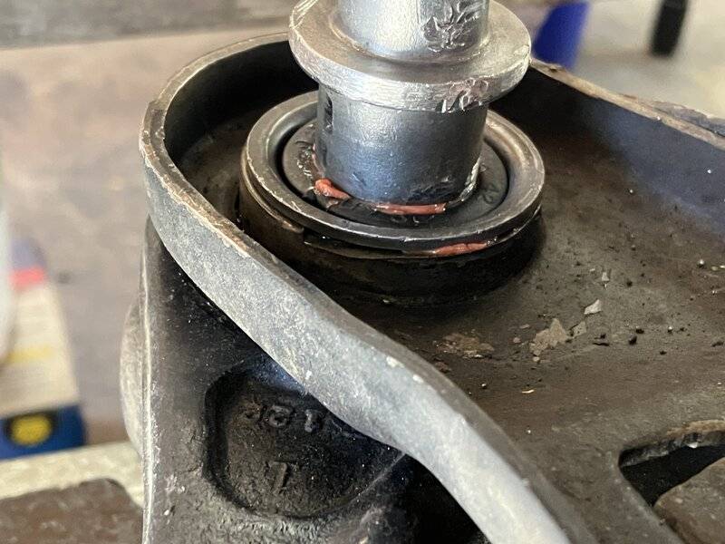

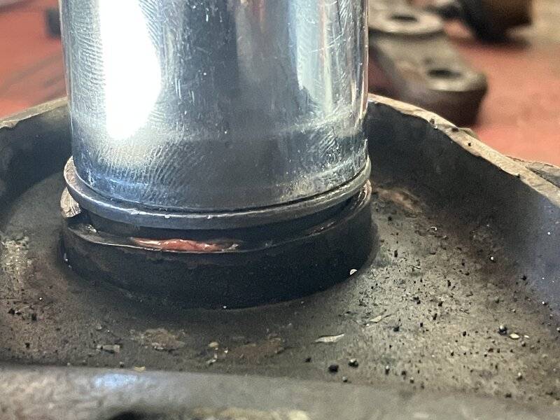

Now this is where you have to be careful, the installation of the pivot shaft.
See the damage I did ?
Looking closer, the inner sleeve got pushed too far in and it tore the rubber loose.
This happens when you press in the pivot shaft if you do it wrong.

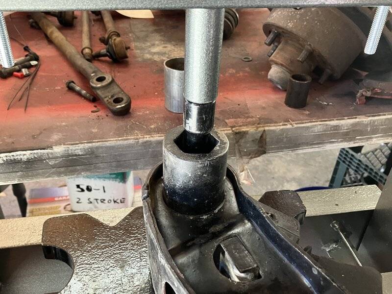

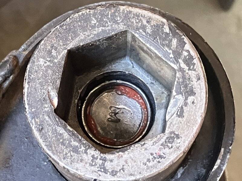

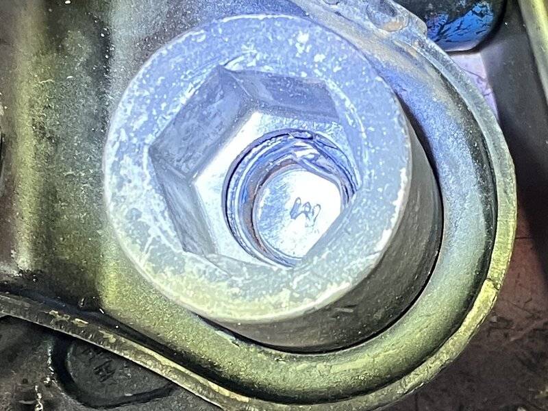

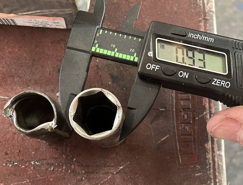

The inner shell/sleeve of the bushing needs to be supported from the back side as you press in the shaft.
Above you can see the rubber deform as the shaft gets pressed in. That doesn’t happen if you support the other end of the sleeve. I measured an old inner sleeve.
A 3/8” drive socket was the same diameter.
11/16” for reference.
With the socket in the torsion bar hex socket to support the inner sleeve…
No damage. The inner sleeve ended up where it should.

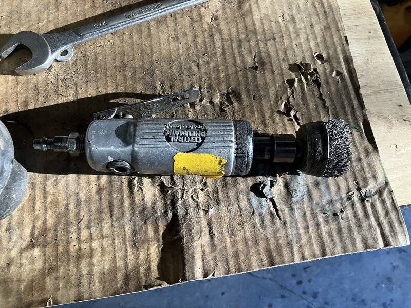

Today was a parts cleaning day. I used the wire wheel on the bench grinder to clean off the dirt, grease and surface rust, then a few minutes in this:

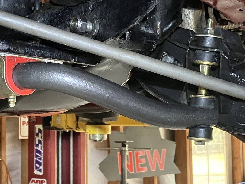

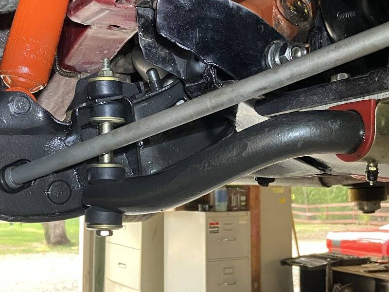

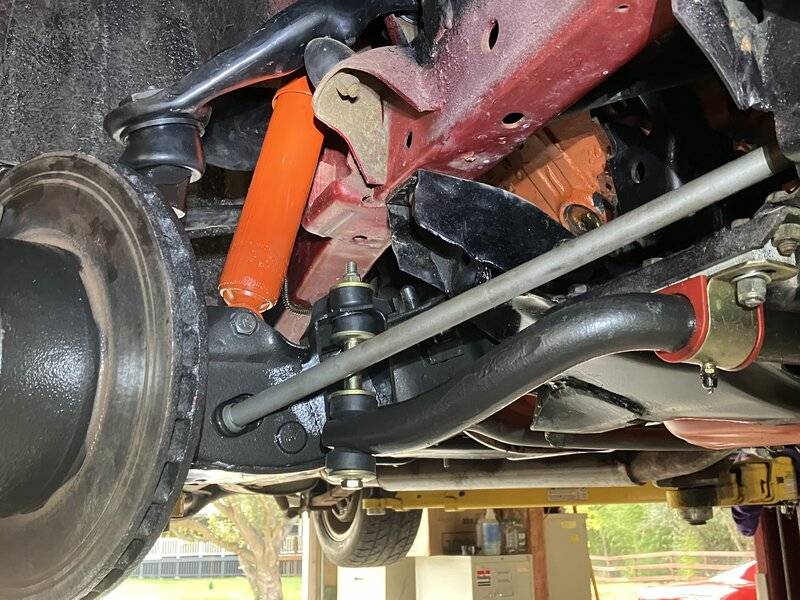

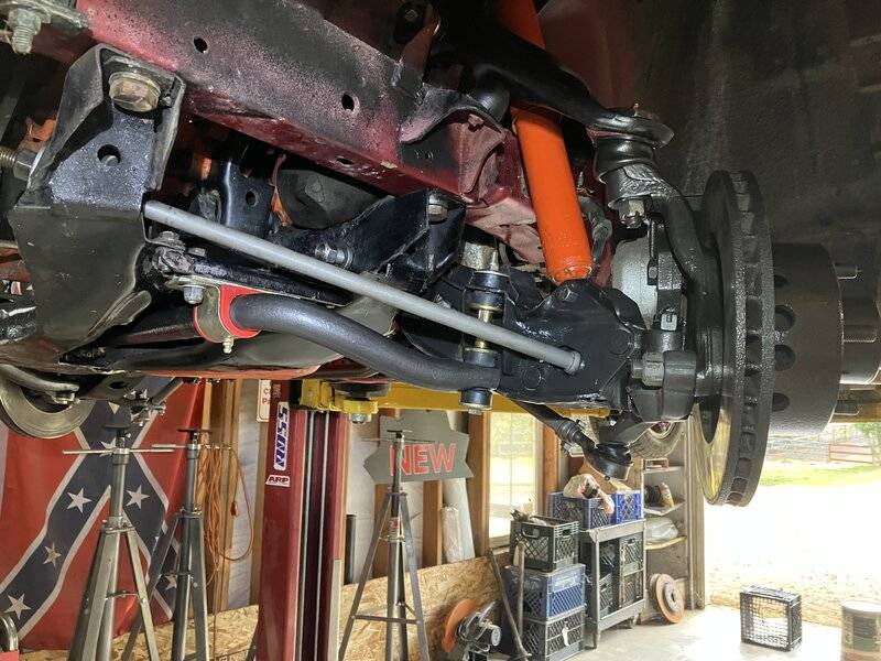

I mentioned this front sway bar earlier…
It won’t look familiar. It is from a 1973-87 Chevy 2WD C-30 1 ton truck and it measures 1 1/4”.
In 2000 I was in the early days of tinkering with my ‘70 Charger and looking for ways to improve the handling. I was under my ‘84 Chevy truck and noticed that the shape was similar to the Charger front sway bar. I found that with a little work, the Chevy bar could be modified to fit the car. The ends of the bar had to be cut back and new holes drilled for the end links. The Chevy bar fit but was slightly narrow from end link to end link. The B body chassis is a bit wider than the 67-76 A body so it turns out that the A body is a better fit.
I’ve made 5 of these for myself and friends. One is in my 67 Dart, another in my Jigsaw Charger, another was put in a 71 Challenger.
The end links are just the right width for this car.
I know, aftermarket sway bars are available but cheap upgrades like this are right up my alley. You can get a bar like this at a junkyard for less than $40. I already had bushings and hardware so this setup was cheap. I haven’t seen any aftermarket bars of this size for this car so that is a plus.
This car still has stock .85 torsion bars and parts store shocks. Even with a worn out front end, it rode and handled quite well.
All four ball joints were bad. All the bushings were too. I did use the shorter length strut rods with the coarse threaded ends.

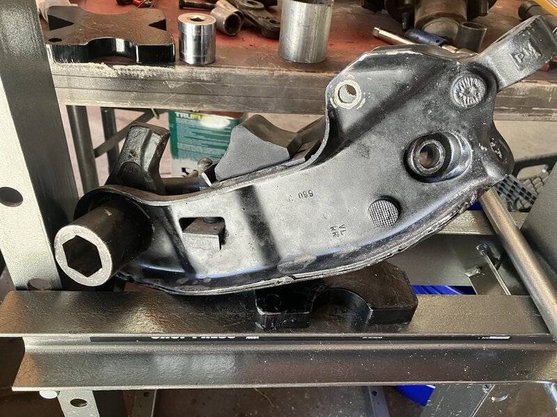

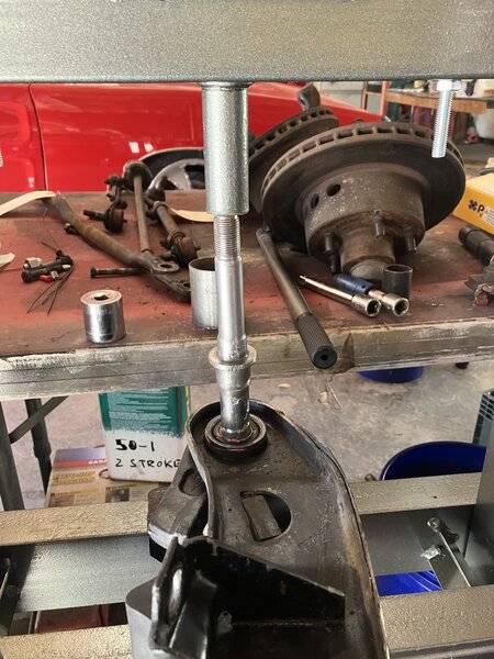

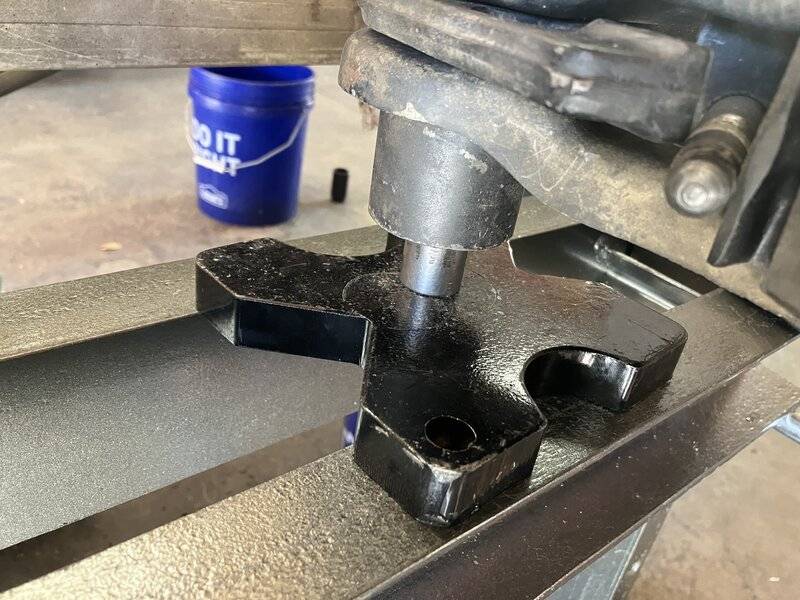

The LCAs....I've never pressed bushings out with a press before. I remember reading about how to get the shaft, the bushing then the shell out but today was my first time doing it.
I'll do the right side tomorrow and post pictures but back to the recap:
I found it to be a bit clumsy....balancing the LCA and spacers to press out the shaft first.
The bushing gets pried out with a screwdriver. That is easy.
If you're using poly bushings, you leave the shell of the old bushing in place but I'm installing rubber bushings again. Back in 2001, I fell for the hype of Polyurethane. Better handling, modern feel...This is true with GM cars where the rubber in the bushings is huge. Ours are pretty thin so when the rubber is in good condition, the added stiffness of a poly bushing is minimal but the vibration increases a lot.

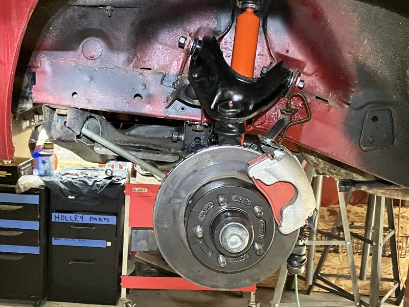

I was at a turning point over the weekend. I had two ways to go: Forge ahead and replace the core plugs in the engine either with the engine in place or by pulling it later OR just finish the front end rebuild and close the book on that.

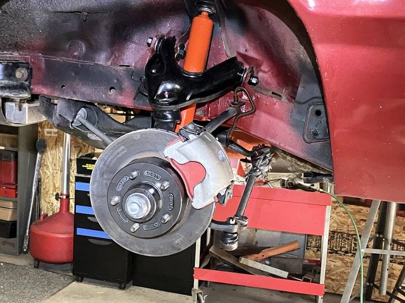

It made more sense to me to finish the rebuild. I got the torsion bars in and set the ride height.

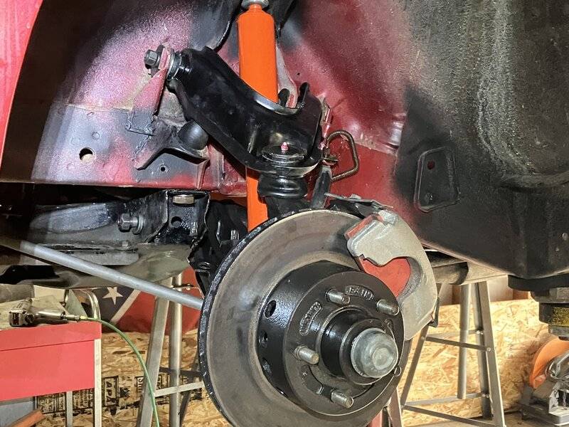

With the torsion bars back in and adjusted, the tires are on, the LCA bolts were tightened and the UCA cam bolts were left slightly loose so I can move them during alignment.

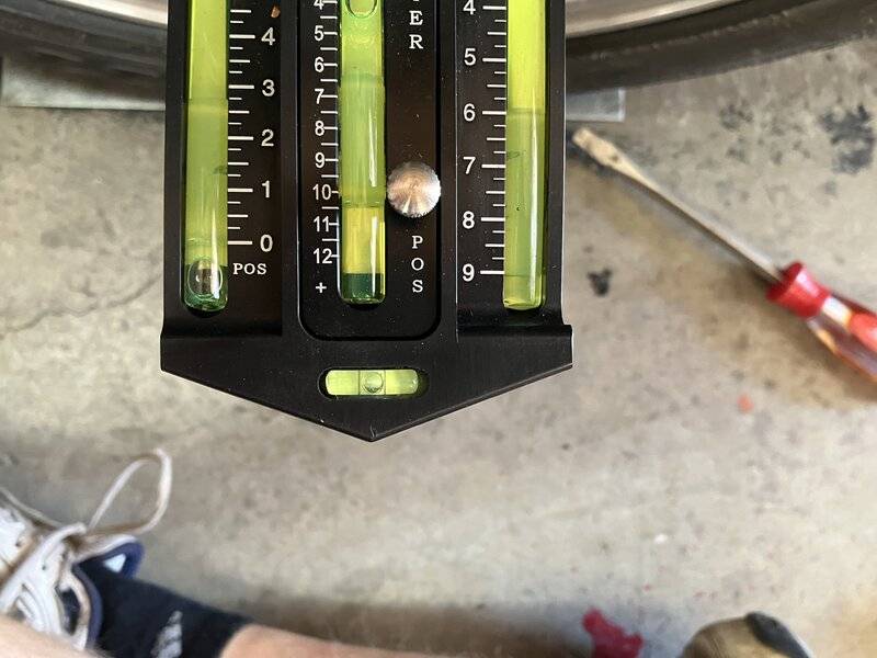

Awhile back, I bought this alignment gauge.
It has a magnetic base to stick to the hub.
The outer bubbles are for camber, the inner is for caster.

You have to "level it" using the bubble on the outer edge.
Next, you look at the outer bubbles to see where the camber is.
Holy crap...I'm at 2 degrees of NEGATIVE camber??
My goal is for 1 degree NEGative camber and as much caster as I can get. The offset UCA bushings as installed will get the most caster possible with stock upper control arms but sometimes the camber can be a variable. Here is the caster number that I got:
6 1/2 degrees of caster? That is great! The problem is, the camber is too negative. By taking some negative camber out, it means losing some of the caster. Remember, I set the front alignment cam OUT and the rear cam IN. If both cams are OUT toward the fender, the camber goes positive. If both go IN, the camber goes negative. Getting the numbers you want can be an exercise in compromise where you settle for what you can get. In the end, I was able to get 1 degree negative camber and 6 degrees of positive caster.
On the right side, I had the opposite problem with camber. I could get just shy of 6 degrees of caster but that was at ZERO camber. Trying to get into negative camber resulted in losing caster.
