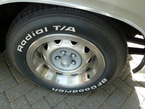

I have a 1968 fastback with 15 inch wheels and 225 70 15 bf Goodrich t/a radials and they have tons of clearance up front so maybe yes the disc brake setup the other owner installed makes a difference, it didn't when I switched mine to disc brakes.

I'm not buying that those are 225/70/15s.
Sorry buddy, after reading all the hoopla about my tire size "not buying that" by the know it alls here I checked and, was my mistake they are 215-65-15 but still have 225-60-15 here that will fit this car and not rub, they are on 15x7 inch mag wheels with identical back spacing and I took them off to put the factory wheels on, just trying to help the guy out didn't mean to get you gear heads feathers ruffled, lol here's a pic so we you can see the size this time

Hey, thank you for checking.
No one here wanted to see someone buy $300 worth of tire and have them rub. You info is still important and adds a combination that has not be listed yet.
