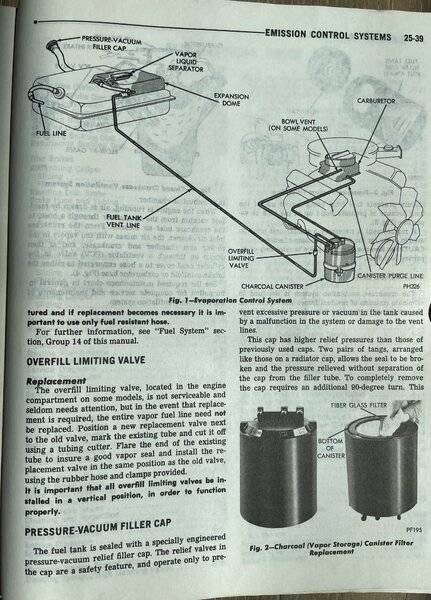

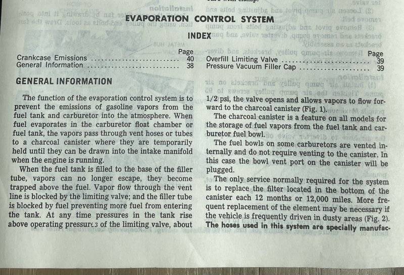

Here’s how the system works (from 75 FSM).
Don’t listen to anyone who says a charcoal canister is power robbing equipment; it is a passive system that doesn’t rob a single hp nor impact performance in any way. It’s there to eliminate the gas smell you have now.
View attachment 1716401510View attachment 1716401511
Thanks a bunch for this! So my duster does not have the canister. The vent line/overfill limiting valve is sealed off by a rubber cap and clamp hose. I just did the same after noticing the rubber became torn off/brittle randomly to prevent the leak that was occurring. Is it recommended to maybe purchase and go back to the charcoal cannister?
