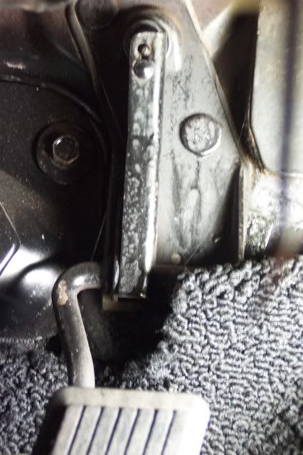

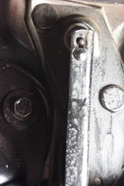

I was just cruising around the Mancini site and I saw a part that I didn’t know existed. Is this supposed to be a roller that goes on the end of the gas pedal rod that comes from the firewall?
The setup in my car is pictured below, and I don’t have a roller; I never knew anything was supposed to go there. If this is the roller I am thinking of, how does such an item hook up? Is it a press on?
Thi is a pic of my gas pedal (minus the pedal) and the roller I am talking about.

I swapped my 66 Dart gas peddle for a 72 duster gas peddle and throttle cable($10).It works alot better IMO than the 66 peddle.Just sayin..
You are missing a plastic peddle & its suspension that would mount on the lower end of that rod.
The proper termination of accelerator cable is a lead slug which is pressed onto cable, and fits through the large hole, and allows cable to ride in a slot above it. A plastic insert fits into the larger hole to prevent cable from popping free. The solution to securing the cable you have looks like it works just fine.
Below is a 1967 & up cable opperated accelorator.
