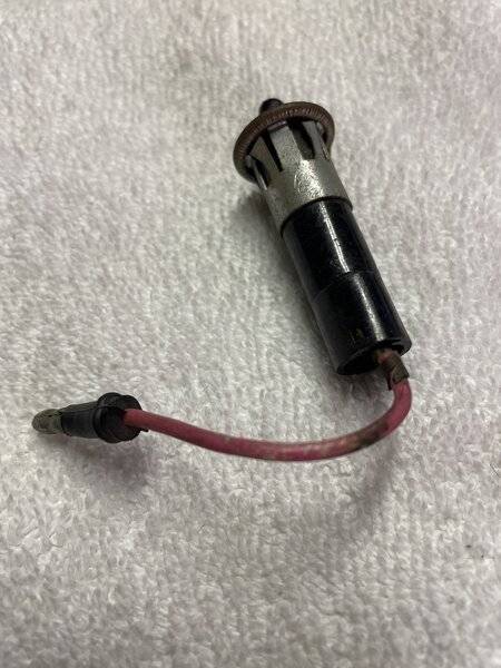

Looking for 67 barracuda GB lite switch. This one works but connection is **** and not sure if switch can be disassembled to solder in new wire. I know the 67-9 Mustang one is very similar.
Is that your switch? Can you not clean it?
Remove the connector by pushing the tang in the small square hole with a small screwdriver in the direction the screwdriver is facing in this picture and then pull the wire.
In a pinch you might be able to open up the crimp, cut and strip to good wire, re-crimp then reinsert the connector.
I don't want to scoop anyone's sale but you can have the switch and connector in the pictures, there's enough wire there I think you could solder your wire to, just PM me your address.
Thanks Winky for the explanation AND the offer! Lemme see if I can get the tang removed and then rewire it.
MUCH appreciated!:thumbsup:
