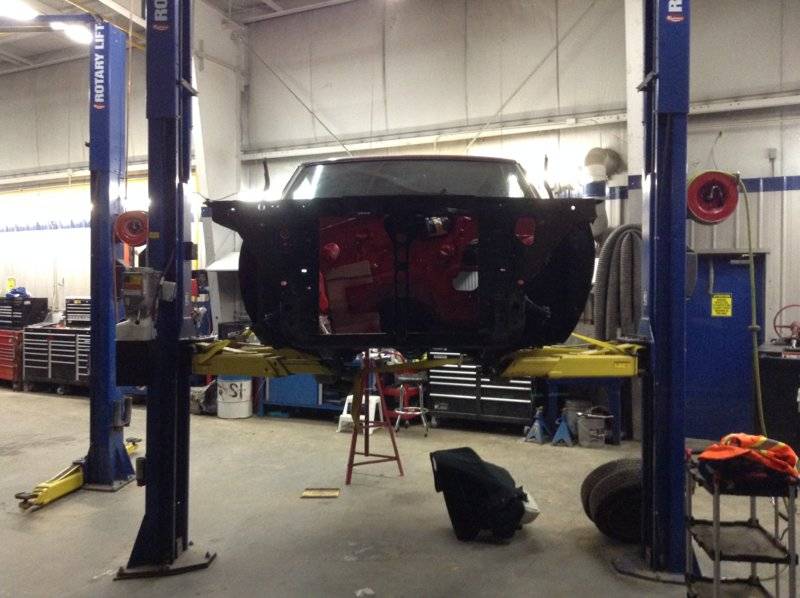

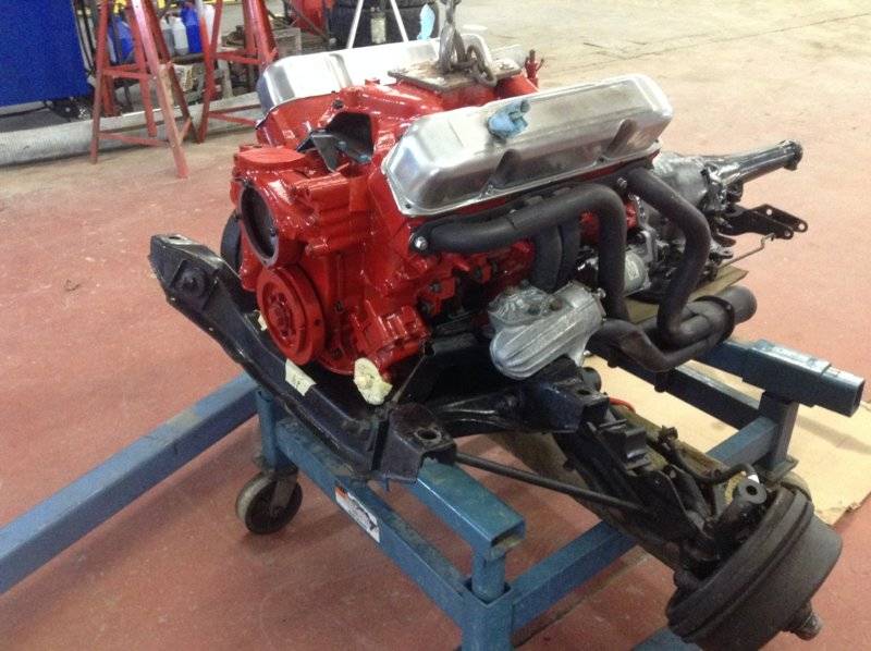

Just finished my project almost identical to yours. It's a 69 Dart. I used the big TTI's, yea a bit pricey but ya get what ya pay for. Picked the car up with a cherry picker (don't really need a lift) rolled the engine under using my homemade wooden stand with headers, and K-member attached (could of added brakes, shocks and steering
linkage as well. However being by myself got a bit stressed; it slid in WITHOUT a scratch or ding on the $1000 set of headers and bolted it in. The only difference between mine and "383Scampman" was mine is a floor shift vs his column shift. Never again will I go in from the top however each his own. Here's the link.
