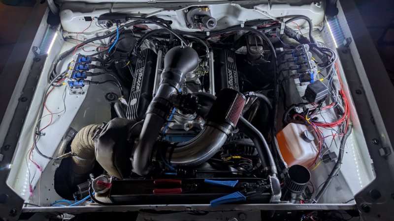

These wastegates are driving me nuts. They come with 2 springs. Supposedly one is 4.6psi and the other is 5.4psi and should be about 10psi combined with a crack pressure of around 8psi according to the paperwork. I figure they aren't going to be exact. But they seemed to make a bit more boost than advertised at first. about 6.5psi on gate only. Then I went to a test n tune, boost controller off. Launched on 2 step pulled pretty good but felt N/a (11 sec engine at 6500+ft da n/a) which is basically what it ran. I check my data log 0-1.5psi of boost w t f.
First run was a botch ran a mid 7 1/8 mile then the throttle cable came apart. Second run I fixed it and wanted to make sure that I wasn't dreaming and sure as hell, 0-2psi.. . As the car slowed down I heard it, one of the wastegates was stuck open, found it was so close to a support that when the engine torqued it put just enough pressure on the cap of the piston housing of the wastegate that it flexed just enough to hold it open. Got the car home and made a little notch to give it some space. Made sure everything was smooth and not binding up, put the small spring in and made 3.4psi on gate, 100% duty cycle was about 7psi. Put the big spring in made 4.5psi 65% duty cycle was about 7psi. I just put in BOTH springs you would think it would make about 8psi... it made 5 on gate only. I'm ok with it, but damn, I'm not sure I want to run compressed air or c02 yet. lol
Sounds like you either have significant hot or cold side leaks or you have a lot of drive pressure forcing the gate open. On gate pressure does the boost curve fall the higher you rev it? Also. You could unhook the reference on the bottom of the gate and see what it makes. My old stuff would make like 3psi with the reference hooked up and 9 or 11 with the reference removed and only exhaust pressure opening the gate.
It holds steady, boost doesn't drop. I'm starting to think that maybe it was messed up and fixing where the bottom gate was hitting allowed everything to work properly and this is just normal. The exhaust is 2 1/2" merged to a single 3" vband to t4 1.25ar with a 4" downpipe, 2 50mm piston style wastegates it's possible it has some good exhaust pressure it is a 408ci with a healthy cam. It seems to be following the boost controller properly.. 3.4 psi gate @ 100% made 6.8-7psi. At least it's not running away with boost anymore.
