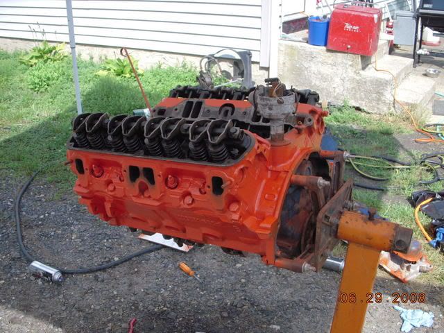

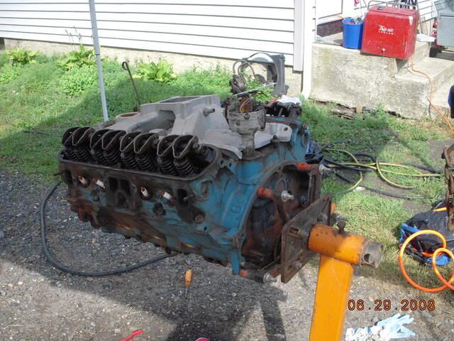

well i got tired of not driving my dart all year. decided to take my time doing the 408 and just drop a stock 360 i have had for a while in it.
so i yanked the motor on 6-17 gathered the stuff i needed , cleaned it up and damn near killed myself getting it together this week.

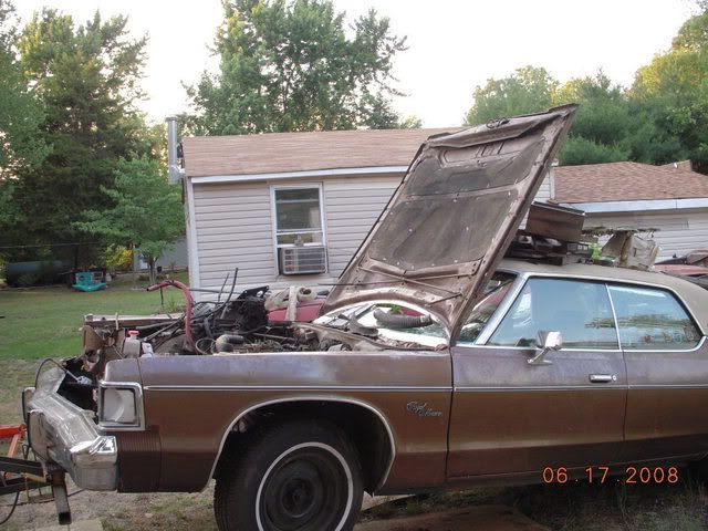

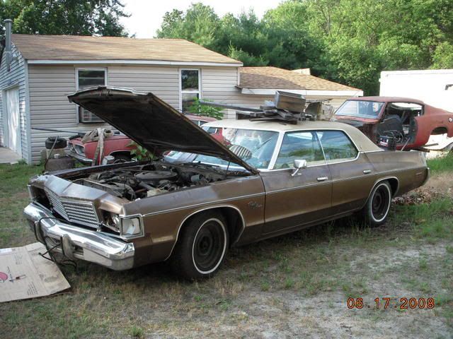

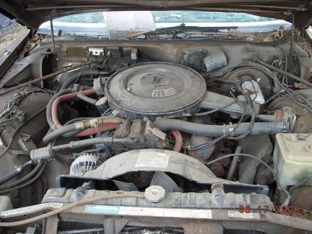

what better to use for a donor car? yup a c-body. this one has the jeep hood option...lol

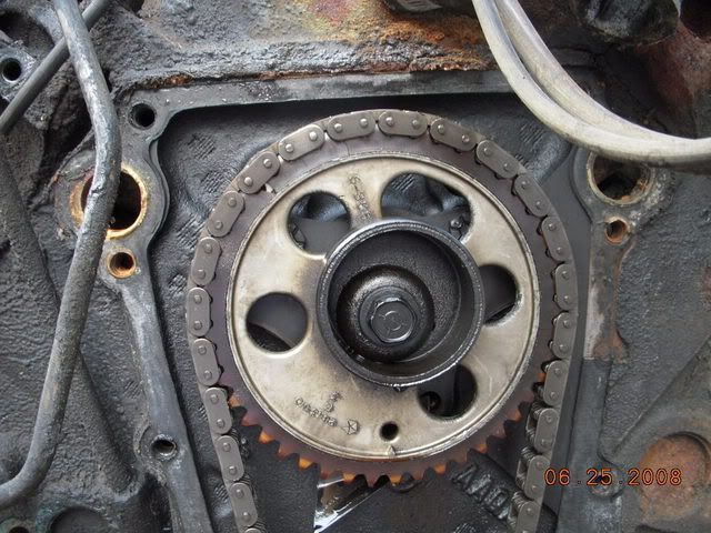

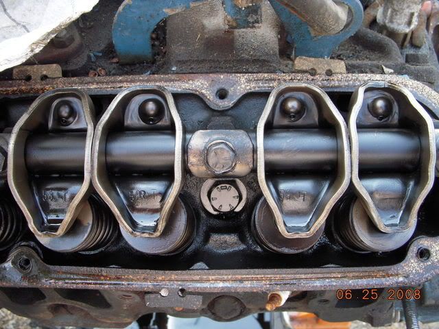

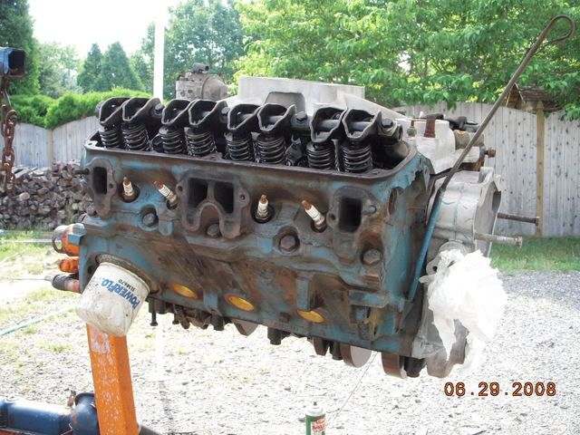

no suprises here. timing gear is cracked and alot of play in the chain. put a double chain and new oil pump in. and you can see how clean it is. someone kept tyhe oil changed. motor only has about 48,000 miles on it. i knew it ran good about three years ago but haven't had it running since.
Ah, the lovely nylon cam gear. WTF were the big three thinking?

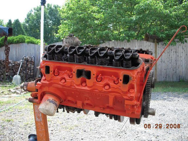

Top end does look nice.

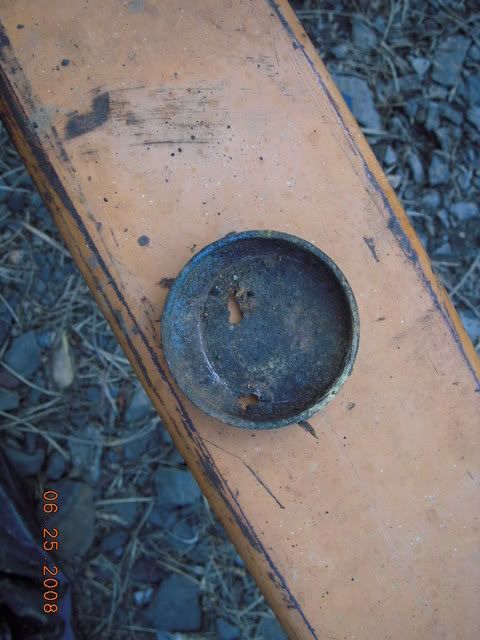

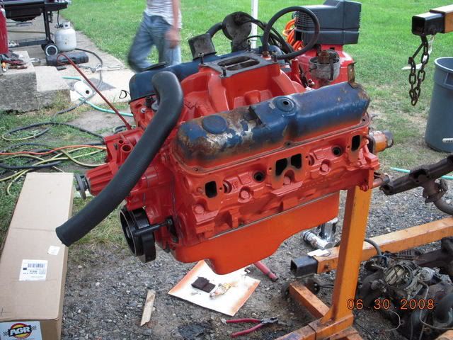

had a rusted freeze plug. i knew about that three years ago so no suprise. and as usual all the slop was in the corner by the starter. i replaced all the freeze plugs and cleaned the motor up as best as possible for a temp motor..:)

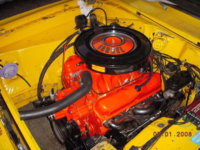

spray bombed it with some duplicolor. its no urathane uteck 3.8 but it will do.. it actually matched the urathane pretty good too. suprising..

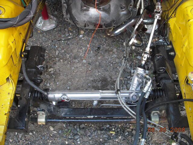

after i blew it up in oct. i decided to make it more of a cruise. so i bought a power rack for it. straight forward install there.
dropped it in and hooked everything up. the power steering pump and lines were the worst part of it. ended up walking away from the pump and doing everything else that could be done until i had to put the pump on to finish up. by then i guess i colled down and it went on pretty easy.
