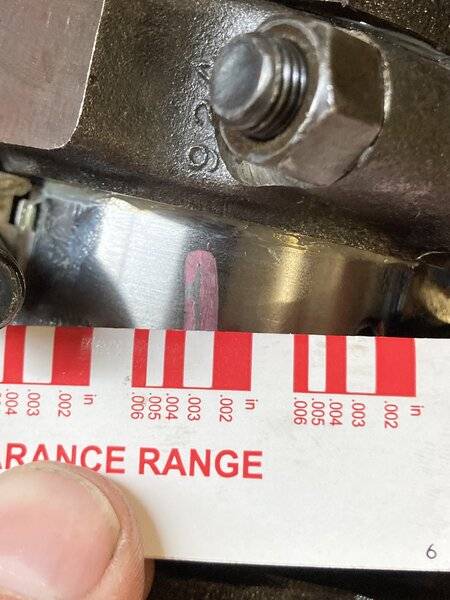

It's the first time using a high volume pump. I'm guessing I sucked the stock pan dry while passing a minivan in high gear. Tach was climbing past 5500 before letting off and the knock started immediately after.
If that is the failure mode you would find considerable damage to most of the bearings, for sure not just one. What do the rest of the bearings look like?
The rest of the bearings look good.
With the "rest of the bearings look good" your HV oil pump did not suck the pan dry and cause the failure.
Were the rods resized properly by a engine machinist prior to reassembly?
Did you measure the bearing clearance for all 8 rods during assemble?
This was my first engine build from start to finish. I didn't have high expectations. I only checked a couple rods/mains but they were all the same. Ring gap was at .020 (also only checked a couple) The crank was from one engine, rods and pistons from another, nothing balanced. Block has ate 5 sets of rods/mains. The fact that in ran at all was a surprise.

The 5 sets of rod bearings were from a reputable engine shop. I had a fresh block bored and it still ate the bearings (this is the block I was using when I spun the bearing) The only thing left to replace with the other rotating assembly was the crank. The plan was to have another crank balanced with my good rods and pistons. I had it at the builder for like 4 months and they were to busy so I decided to pick it up and throw old parts together. It didn't work out but neither did "doing it right"
