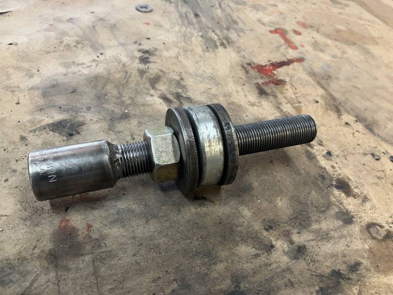

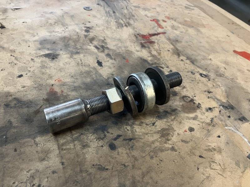

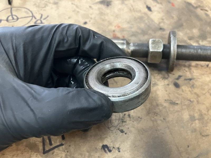

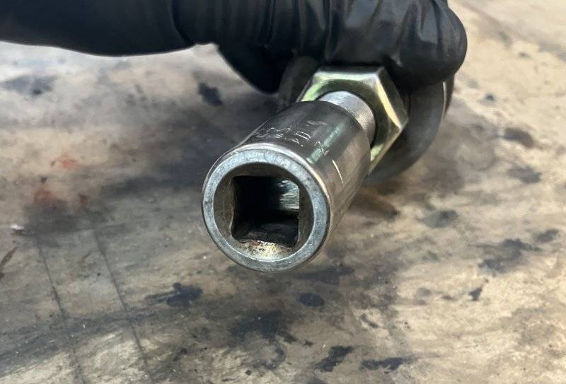

I made two using a piece of allthread bought from Grainger....
