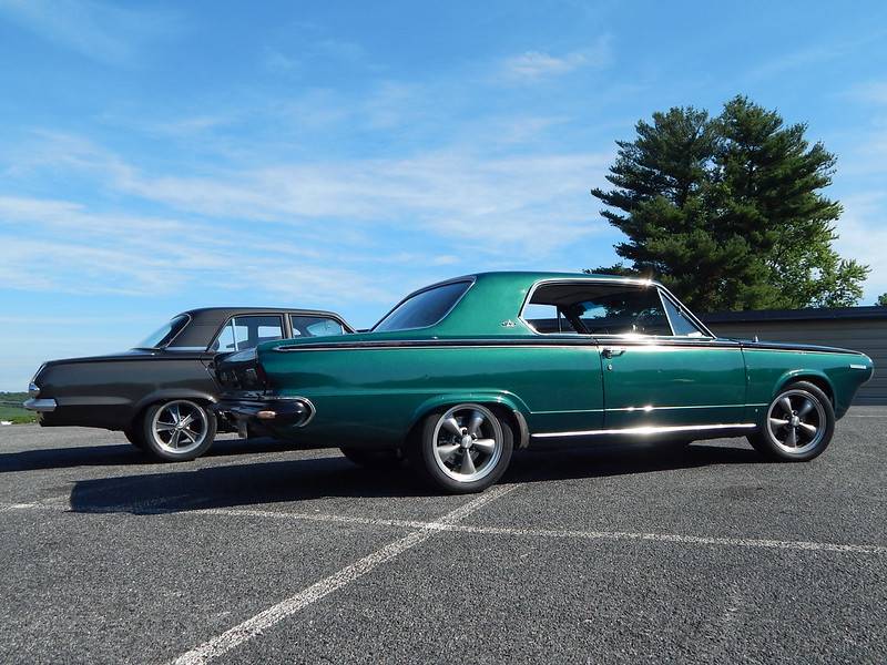

I have The High Offset *(+45MM) Bullitt Wheels on my car for street use.. 17X8 - 245 45 17's Since I have a '69 B Body Rear in there I actually machined the Rear wheels to +52mm for Clearance on the outer Wheel Lip ('67 B Body Axle in the works to solve this)...Here's what that looks like:

When you run 3/4" to 1 1/2" wheel spacers the caps ( grease cap and wheel center cap) do not interfere with each other. Use Press in 3" or 3 1/2" Studs in your hub or Brake Rotor.
(these Crusty OE MoPar Brakes are no longer on the car - Baer 13" Rotors with 6P calipers reside there now) You can also Stack spacers to get the Offset you need. 1/2" 3/4" 1/4" 3/8" etc. Sometimes if I change wheels I change the Spacer stack as well.
