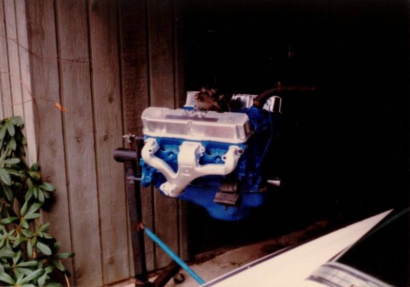

Early '80s I had a '65 Barracuda with Commando 273/4-speed, manual steering, power brakes. I rebuilt the engine and put 340 exhaust manifolds on it. They fit but the ports were obviously much larger and the exhaust gaskets had very limited head surface to seal to, from what I recall (pretty dim memory that far back). And as stated previously, the drivers side outlet dumps in a less than ideal location (onto the starter wires if I'm remembering right). I drove the car with open manifolds to a shop and they installed a full dual exhaust on the car. The photos are circa 1981.
