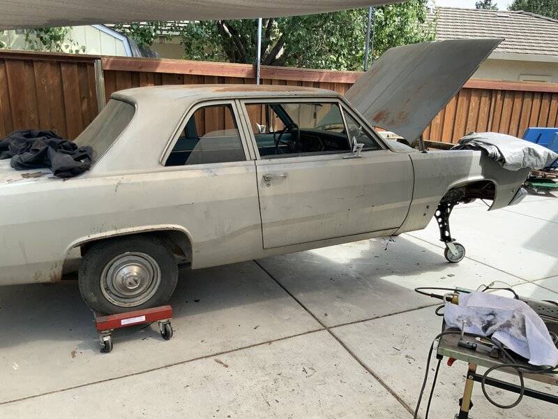

Have a post 2 door 68 valiant , we rolled the floor pan like a taco without putting creases in it used a strap to hold it went write in through pasenger door. Me and the wife easy peasy surprised my son
when he got home. Have pictures after the fact but here u go.
