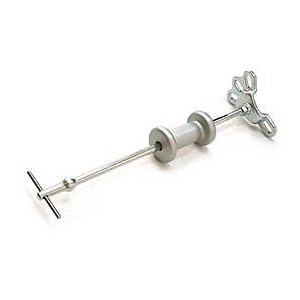

Take the drum, turn it around mount on studs and run a couple of nuts down on it. Use it like a slidehammer.
Yup and sometimes THAT is not enough. The recommended tool is a big assed slide hammer
We got it, used a come-along, mounted one end to a main supporting beam in the garage ( ;) ), and hooked the other to the axle. Then put tension on it, and I leaned against the car so it wouldn't tip off its jack stands, then tapped on it with a hammer. Real safe.
Take a chain 3/8 or 1/2 atleast 6 ft long, bolt it to your lug bolt. Get some slack in it then whip it up and down while you snach on it. Wear gloves or use a shop towell. Works ever time.
