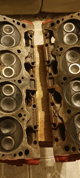

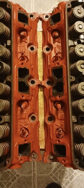

Here are a few pics of the X heads I brought home the other day .
You can see the X’s are large and prominent,,,,both outside and underneath .
And the casting number is 2531894 . These heads were cast in 68 .
These pics were sent to me by Mtrhead ( Will ),,,,and I’m very glad I purchased them .
I also got another excellent set of rockers with Banana shafts .
Very happy with everything I have bought from Will in the past few months .
Good guy to deal with and is very knowledgeable on his Mopar stuff !

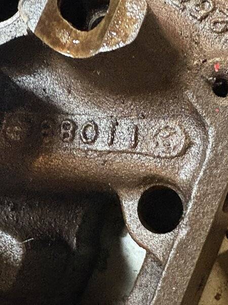

The 1190 indicates that the head was cast on September 3, 1970. The head was likely installed on a 1971 model engine.
The "X" foundry mark is meaningless regarding the 318 head application. Some 340 heads had an "X" foundry mark cast in multiple spots. In the case of the 340 head, the external "X" can be used to identify it as a 1968-1970 casting number 2531894.

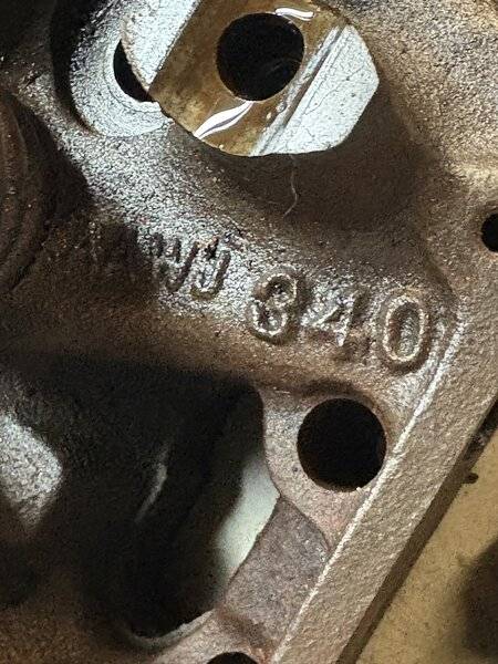

I believe X heads also say "340" on them somewhere under the valve cover whereas J heads will say "360" etc.
Yes,,,you are right,,,340 under the cover area .
I just took these pics a few moments ago .
Also,,,Vaanth knows his stuff,,,,he’s pretty sharp on the foundry information .
Here are several pics just now ,,,these are both heads,,,cast on the same day .
Tommy
