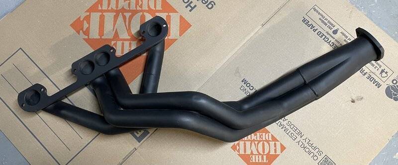

I have TTI long tubes on my small block. Zero dents none and they clear everything. But I had to shim my motor mounts to get engine correctly located. And I run Schumaker Torque Strap to keep engine from moving. My TTIs are prone to surface rust though. But they are 16 years old still in good condition
I have a set of TTI's on my 67 Barracuda 360. Fit perfectly with no massaging of the headers or anything else at all. I do have manual steering, though.
Now the TTI's on my 65 Barracuda weren't so easy, had to ding one tube for idler arm clearance, and another for clutch Z-bar clearance. Plus move cables and wiring to the starter, and re-route brake lines. Plus shorten the steering column jacket. But the 65 has a much smaller engine compartment. I was actually pleased that they fit so well.
I've done TTi long tubes twice, once in 70 Dart 360/727, and once in a 75 Dart Sport, also 360/727. No muss, no fuss, no hammering required.
Just make ABSOLUTELY SURE that your engine is located correctly. Read the installation instructions carefully and you shouldn't have any problems.
