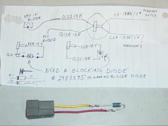

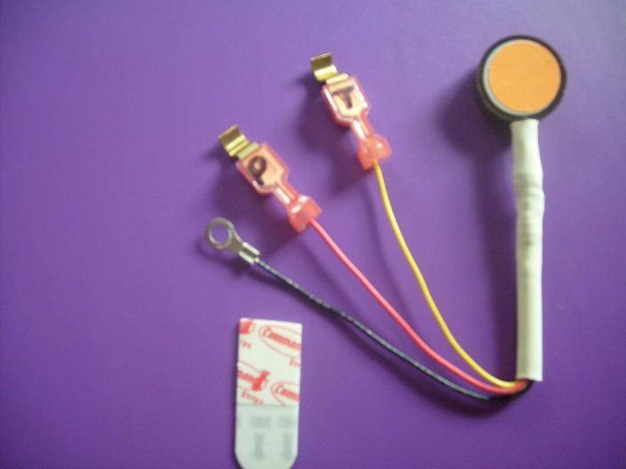

Mine is shaped like a lollypop. The buzzer being a thick candy and the logic circuit being the stick about the diameter of a pencil. 3M Command adhesive pad on the backside of the buzzer. Fuse taps and terminals for the red and yeloow wires and a forked terminal on the black wire thats placed under the screw that holds the fuse box to the dash.
But... nevermind.
This is how It is setup from the factory on my B body.
OK What was a 92 db buzzer is now a 86 db . About 2 dollars saved there and still plenty loud enough. Pre-printed heatshrink tubing was deleted also.
I still have to get 18.25 for it. I'm sure some chinaman can build it for less but I cant.
Package is complete and install is so simple you could do it in the auto parts store parking lot . What do you think ?
