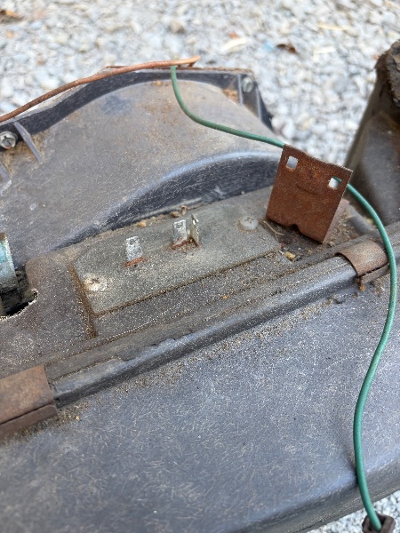

I have a 74 duster. Heat. It does not have air. What are these 3 pins on the heater box?
Okay makes sense. I’m guessing wires should be coming from the controls?
Those resistor terminals are the same for 1973 and 1974 Abodies.
Go to the 1973 Dodge chassis service manual and look on page 8-170, then diagram CI-33.
The green wire in your photo probably goes to the single terminal on the right.
Perfect. Thank you. Going to need a heater core and I’m trying to save the fan motor
Does anyone know which wire is hot going into the heater switch? It is a 3 prong wire. I have a red/white wire that is hot whether the switch is on or off. It ties into the heater switch and runs back to the resistor. Is this correct?
I figured it out. There was another plug I was using that was the same shape plug
