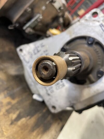

so this fits in the first step in the crank shaft ?
man my mind is blown, i just figured it out LOL
Yup. That bearing goes into the larger diameter cut which is typically used by the snout of a converter for an auto trans.
I use the roller bearing in my 4spd 408 setup. So far, no complaints.
this has been some good new for the day !
i didnt even think of that, i guess thats the extra 20 years of experience :)
i am a bit worried that my OD is a bit too small to fit that bearing tho, but i could machine up a bronze bush

That's what I would do. I don't htink the smaller tip is too weak or it would have snapped off in it's previous life.

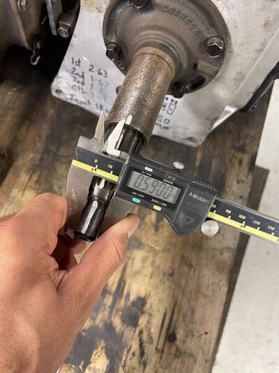

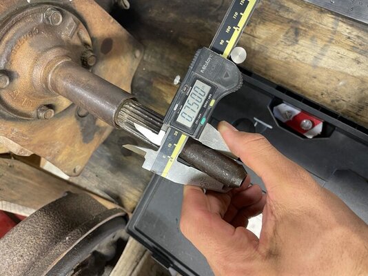

And measure the shaft precisely.

i looked at the roller bearing on brewers and its sized for a normal size .75 shaft,
so ill either have to make a sleeve or a stepped bronze bush with a .6 ID
something like that, the 1st step may not be necessary but if i have it on the lathe and the material then why not.
Thanks all for the idea, i didnt even think of using the auto spigot,

I think that bearing is a off the shelf for a .75 shaft thats been cut down for whatever reason which makes sense,
I wonder if that make one to suit a .6 shaft, ill have to see and look
