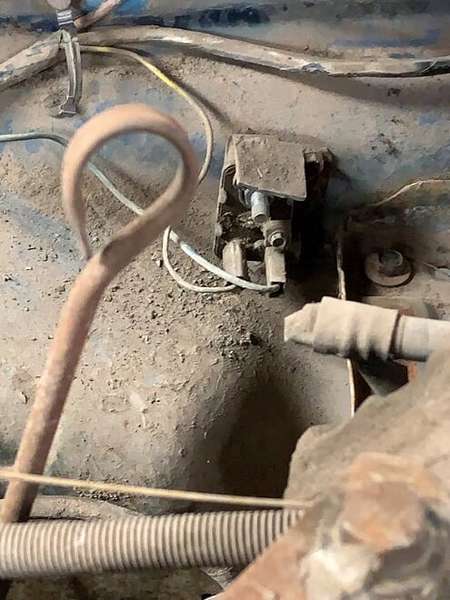

    We've got a part that they need help identifying. It appears to a relay of some sort mounted behind the battery tray on the driver's side fender. Anyone know what this is?

      Is that the starter relay?

        Starter relay??

            Unanimous......so far lol. Starter relay.

              Thanks everyone! That's what he thought but he wasn't completely sure. Thanks for the confirmation :). He apparently pulled some wires before they sent me the pic, so he's got it figured out now with your responses. Should be a good Christmas, once they leave on Thursday I've gotta high tail it right behind them and beat them home so I can see the look on the face when he can't pull into the garage because his car is in the way!
