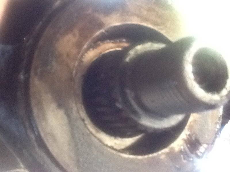

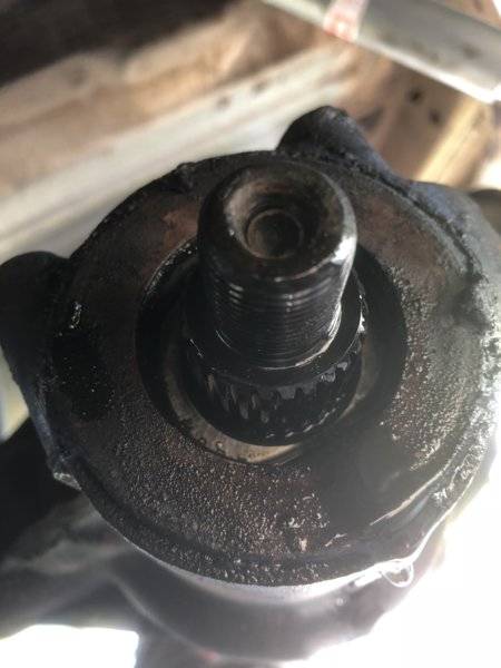

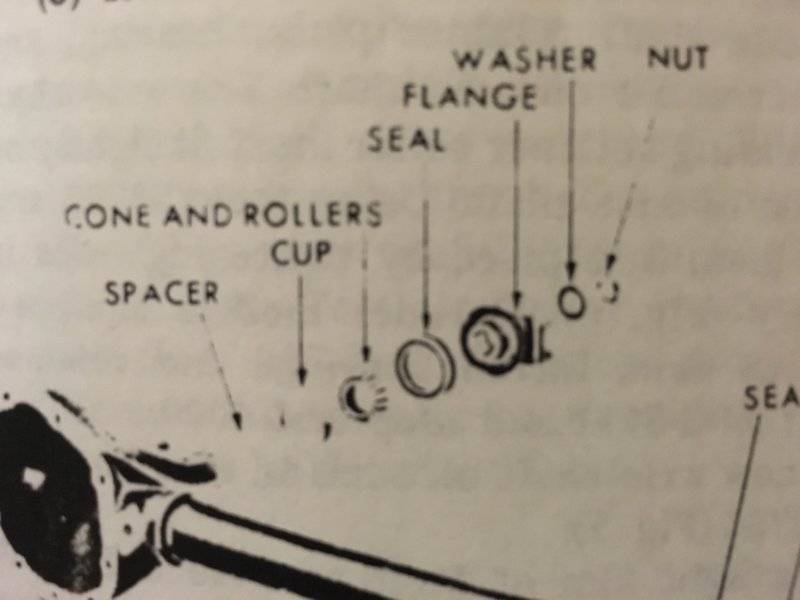

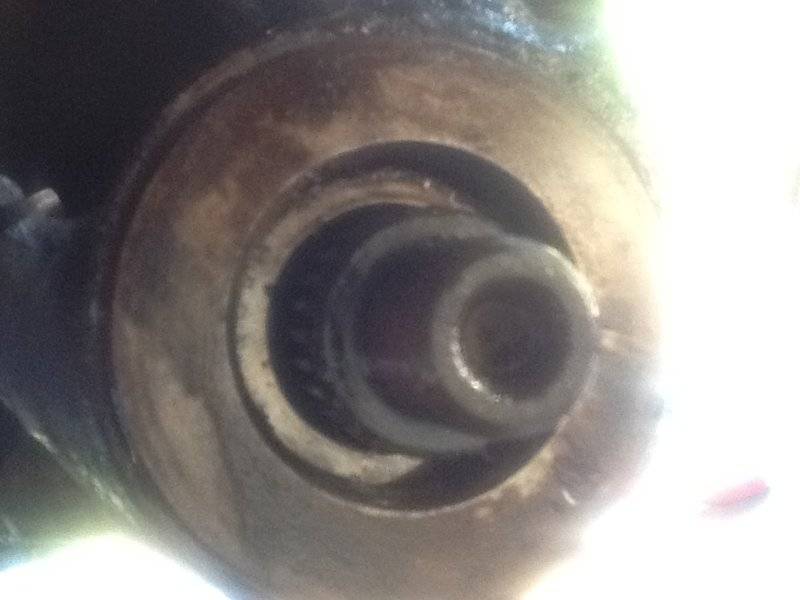

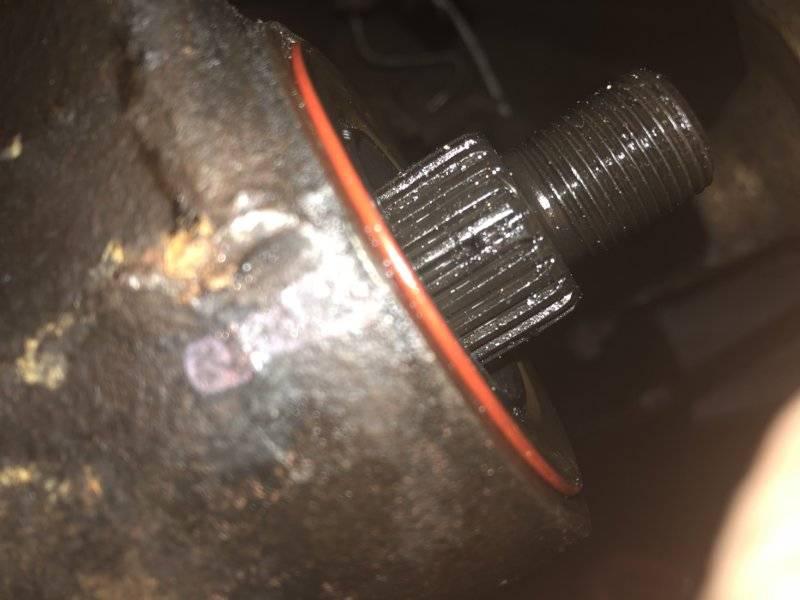

Got it off with a steering wheel puller, just had to spend a buck on longer bolts. Worked perfect but now another issue.....I included pics that show what I assume to be the seal but it doesn't act like one. It has no rubber edges or middle rubber around the its center hole. It will easily push in and pull out a little and it spins freely around the pinion shaft if you put a little pressure on it and spin it. I can get a a small pick on the center but it won't budge. That can't be an outer bearing race and I'm completely missing the seal?? Could it? I just don't see how whatever this is is meant to come out. Help would be appreciated. Pics of the deal attached....
Looks like you've lost the rubber on the larger diameter piece (seal), the smaller diameter piece is the pinion bearing.
Yep I checked that diagram in my manual and I thought it should be the seal I'm fighting but it just acts odd. Can I punch a flat head screwdriver between it and the casing walk without doing damage and causing a new seal to leak? I see no other way to get it out. I can gently get a small pick tool to grab it a bit by the pinion shaft but not enough to move it and I don't want to force it there and damage the shaft.
Look at your new seal,you can tell where it fits. And test it in the pinion yoke to make sure its correct.
I always do.
I have a small pry bar i can drive against seal,forcing it in towards pinion shaft, that usually frees it enough to pry out.
The way you were planning with the screwdriver should work. I
Have chiseled the seal,to collapse it then it almost falls out.
So.....Used the "tap one end in and pry the other" method and got the seal out. Hammered a screw driver into one side of the seal and after a bit of prying it popped off. New seal in tomorrow. Thanks everyone for the help!

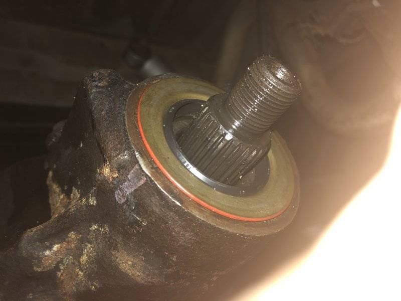

Pinion oil seal in with no issues although it doesn’t want to completely flush with the diff body housing. It sticks out a touch but is equal distance all the way around. The old one wasn’t totally flush either. Is this as it should be? No amount of pressing seems to push it in anymore. Pic of old one and new one attached.
