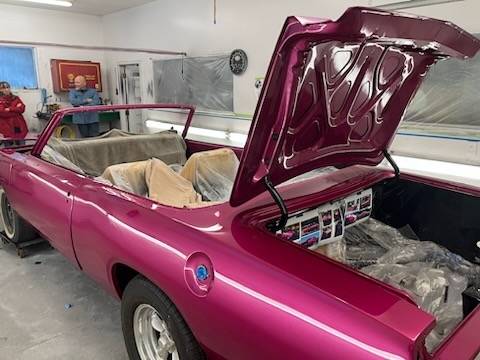

Last year we spent 6months paused tracking down a usable trunk lid for my '68 Bcuda Convertible project. Now that the interior upholstery work is complete we are back to assembly at the body/build shop. Tuesday we ran through our extensive list of to-do's to align work for the 6months we'll be away in Tucson fro the winter. We've come to realize the trunk came from a '67 and would like people's validation (pic below and will exchange the taillight lens to match to the '67 if that is what it is versus a '69).

Yes indeed it is a 67. The holes for the trim prove that. Also, does the underside frame of the lid have openings or is it one solid piece? That is the easy way to tell the two, 67's have the open underside frame. Lids are the same for convertible and coupe. There are three separate aluminum trim panels for the 67 while there are only two for the 68 and very hard to find in good shape. What is your main plan, to have a correct 68 or does in matter?
Yes indeed it is a 67. The holes for the trim prove that. Also, does the underside frame of the lid have openings or is it one solid piece? That is the easy way to tell the two, 67's have the open underside frame. Lids are the same for convertible and coupe. There are three separate aluminum trim panels for the 67 while there are only two for the 68 and very hard to find in good shape. What is your main plan, to have a correct 68 or does in matter?Thanks for hte reply ... Not sure if theopening on trunk underside is referring to the holes drilled thorugh or something else. I attached the only pic I have below (it's 75miles away from me but will be there Tuesday).

Yes, 67 lid for sure. Finding the center 67 trim piece is easy, the top piece not too hard, but that bottom piece is really hard to find in good shape.
