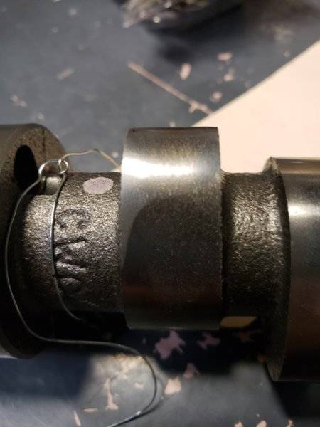

I don't see anything wrong with that cam but it could be worn a small amount and not be visible in a picture. Only takes a few minutes to check lobe lift if you have a lifter and a dial indicator. If the cam lobe is worn down then the engine needs to come out for a rebuild since that cast iron dust is now floating around inside the engine. I'd double check the cam for wear before I rebuilt the engine, especially when the cam doesn't appear to be bad.
So I've always run a top grade synthetic. The cam is out and still at the shop. The reason for the teardown is I overheated the motor by throwing the fan belt, and it seemed to me the valve train was noisier than it was before. Altho I didn't see anything in the filter they said there were some fine particles settled in the oil pan.

FWIW, I agree with the machine shop...... there looks to be some abnormal wear on that cam.
I can’t tell if it’s two different lobes, or two pics of the same lobe.
2 different lobes.

Stopped by the shop today and got a better pic of the worst lobe. The center is actually concave. Think I'm about ready for a roller!
