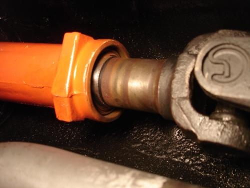

Before modifying something else I would deal with the short drive shaft first. Something messed the old yoke up and it is pretty likely still involved in what you have going on now.
Very good point; I didn't read that in this post. The depth of the yolk into the transmission will affect driveshaft angle, which will in turn affect the u-joint angle. That issue will need fixed prior to attempting to adjust u-joint angle.
You didn't read it in this thread because it is in a combination of three other threads.

Bill, I would recommend getting a longer driveshaft and having it shortened or have a driveshaft made for your application. You can find the length you need by inserting the yolk all the way into the transmission, then pulling it back 1"-1.5", put a u-joint cap into the yolk, bolt a u-joint into the pinion, and measure from center to center of each u-joint cap. When I accomplished this measurement on my Duster many years ago, I did it with both caps facing down towards pavement. I provided that measurement to my driveshaft guy, along with another driveshaft I had that was too long, and he was able to shorten it to what I needed. You may even be able to find a shaft that someone else has for sale that matches your application.
you guys have been a great help. I am going to deal with the driveshaft first. thanks for the info. I will get it eventually. thanks
