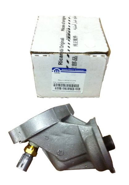

Anyone running the 90 degree oil filter adapter with the hemi. Does the adapter and filter clear the K frame etc?
If so does it have much clearance as i need 10mm to the k frame for engineering reasons. The 90 degree adapters are not cheap however i want to avoid a oil filter relocate kit as think they are messy
It should as the holley only brings motor forward i would think its the same height

the only thing that might give you fits is the sensor on the back of the unit. might have to plug and move to a different location.
Anyone used the bouchillion unit as looks to have a smaller 90 degree bend and a longer arm so pushes filter further away from k frame. Not cheap tho
They (Mopar) do supply a minature oil filter i have been running 1 for 1,000 km without any problems

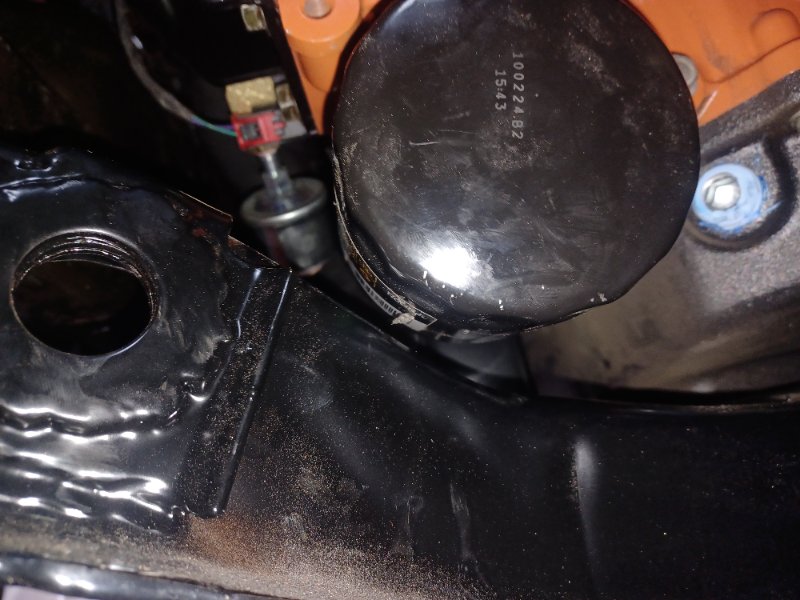

so i bought some stuff to see if i can make work. bought one of these ford 90 degree mounts. the mount screwed right into the block but its soo tight that you kinda have to angle it weird. unfortunately i forgot to take pics of it mounted when i still had the engine in there but the filter will come out behind the alternator in between the k member area. ill need to trim the motor mount (i have a 6 banger k member). also need to figure out what filter would fit.
O wow ill grab one and have a crack for 30 bucks worth a crack!And it all lines up with everything. I had been looking at these style wondering if any fit. Guessing just get a small ford filter?
in the picture on Ebay it shows a mustang. so, my guess would be a Coyote or some type of small block ford. you can search by car and motor on the ebay site I just did a lot of searching on the web to find this, also the guys on Sublime mention it in their video. comparing data from the actual mounting ring on the spec sheet for filters. the innerweb is a great place.
O yes haha so obviously its a ford 302 filter i would need to work with that adapter
