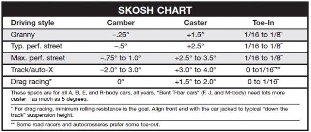

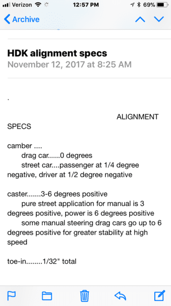

I have a Hemi Denny front end in my 68 Cuda, and love it! What do you guys use for front end alignment specs. I don't do any road racing just normal street driving. Also it is power steering.....

Here's the chart that we normally use.
Thanks for answering 69Dartguy
No problem posting my number....anytime. There are only a few times I won't or can't answer. Church, eating with my wife....and while driving.
