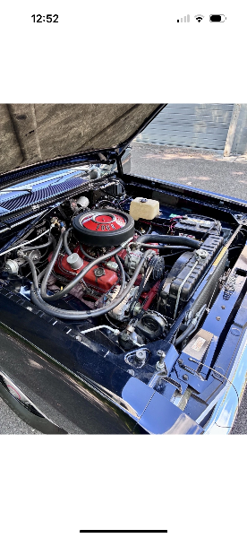

Hi everyone I’m excited to have finally got a car I’ve wanted for decades - a 1970 Dodge Dart Swinger 340. Taking possession next week so I get to see whether it’s great the way it is or asking me for upgrades. It already has power steering and modern vintage AC which were first priority. I’m told my plan to replace the Edelbrock carburetor (supposedly terrible) with EFI is ill conceived. Because the bolt ons don’t work well without the extra sensors that come with modern car EFI. I am going to set aside the factory hood to replace with one that’s without scoops and pins. Frame connectors and maybe a Tremec 6-speed? Wanting a low RPM highway drive. I was also recently advised that a Tremec swap is preferable to replacing the axle gear because the latter is still involved and costly. My seller has the understanding that this car had a Torqueflight from the factory but if true the Mecum listing in 2018 left that out.

Welcome from Texas! Nice score on the Swinger. I just finished a Duster project and put on a Sniper 2 EFI and really like it, but there are a few considerations:
1) You need to be able to install an O2 sensor on one exhaust side 4-6 inches past your collector;
2) You need a high-volume fuel pump to get consistent 55-60 pressure for the EFI. I used Holley's in-tank pump with a built in regulator so I didn't need a return fuel line.
The unit itself doesn't draw a lot of power and the wiring is pretty straightforward.
It runs great on my 350 HP small block - and is really nice on cold mornings, making starting and warmup much less troublesome. But, like everything else on our cars & trucks - it ain't cheap!
