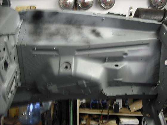

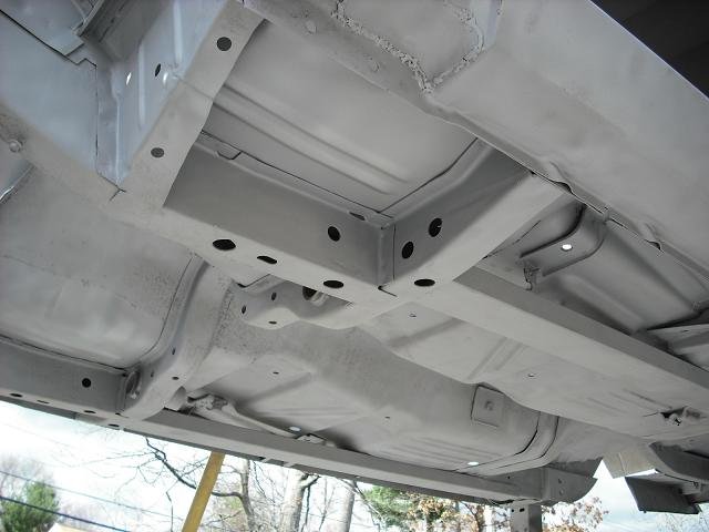

I cut out all rot then had the car sandblasted. Then I used PPG DP 40 acid etch primer to protect the car (not high build). I then would do some body work and use a high build primer for blocking it out.
