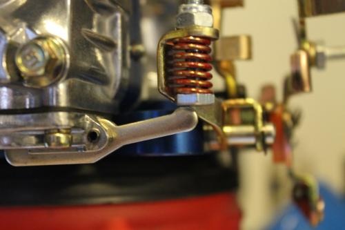

OK, I pulled the carb today and once I removed it, the inside of the intake was soaked. So I tore the carb down and did not see anything obvious. I am taking the power valve in tomorrow to the builder for a bench test to see if its bad. I think the issue is the accelerator pump is not adjusted correctly as the lever is touching and should have a little gap which could be bypassing the fuel. I will talk it over with Dave from Lawrence Machine tomorrow and see if he agrees. Let me know your thoughts.
Well, I went to the engine builder today with the power valve and it checked fine. I got back home and put everything back together, filled it with fuel and put it back on the bench. Fuel is still leaking from the baseplate. I took the whole carb in to my builder and he says everything is adjusted good...floats, acc pump, etc and he has never seen anything like this from a Holley. He thinks that a metering block may have got drilled too deep or there is a crack internally causing it to leak out. I called Summit racing today and they are going to replace the carb for me since it is still brand new. I will box this one up and get it shipped out tomorrow. Then it is a waiting game for a new one to show up. Thank you all for the advice.
