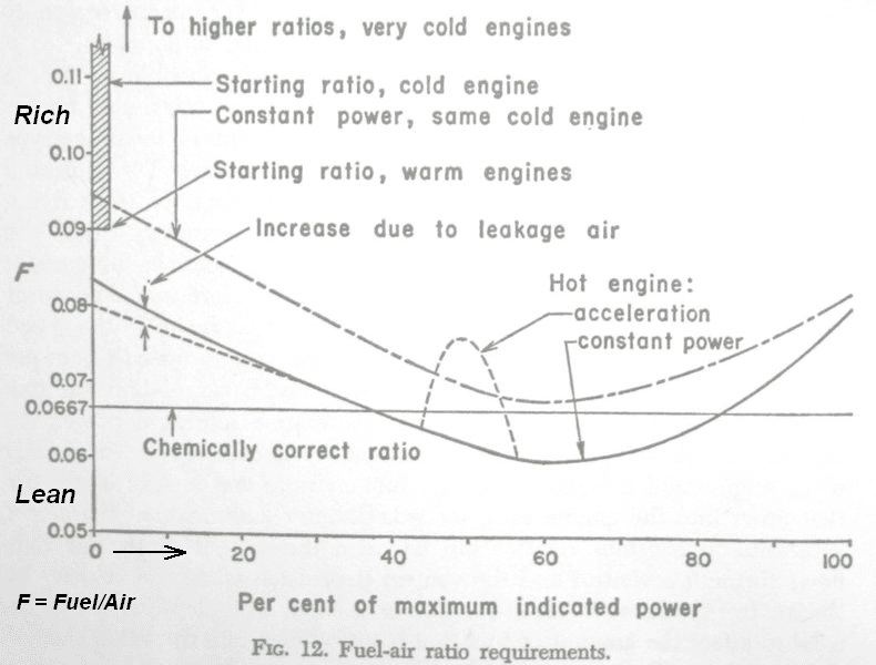

One secret to keep in mind, not mentioned in the book, is about about air:fuel ratios.
As we gently load an engine by increasing the throttle and letting the clutch grab, AFR should get leaner!
Arrow points to increasing load on the engine coming off of idle. F is fuel:air ratio. Inverse that and you'll get AFR but the exact number is not important. Every engine is a little different.
The point is the engine runs best with mixture going leaner as load increase, unless near maximum acceleration or load. Then it needs richer again.
from Walter B. Larew, Carburetors and Carburetion
Big secret.
Big secret. View attachment 1715377260

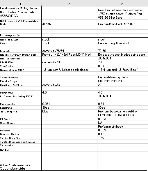

Still measuring holes in carb, but here is my next step

Nope got it all torn apart to do some measuring and install a new Proform base plate, Rear float and Jet extensions.
So Mitty Demon with Proform base and main body, so far.

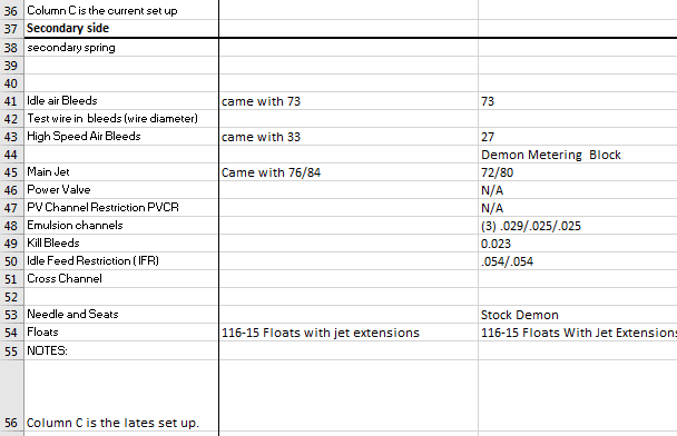

Here is the spread sheet with all the data i have discovered column B is the current or latest setup. I'm going back to the jetting that was popping and banging. If it does it again i will jet it back up. But I want to see how it will act with 4 jet sizes down from Stock Proform Set up.(because i live at 6600 feet) should need less main jet.
If it pops and bangs i'm going to half to except that the demon metering block was calibrated with larger jets then normal and go back up to the jetting that stopped the lean pop.
The Super Sucker is just to help out velocity for a carb that's to big(slow velocity) for my application. One of the things that Dom felt would help.
Woops Primary IFR is the same as the rear at .054"

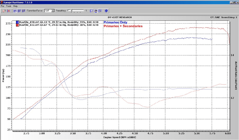

Here's what weird looks like.
When AFR looks like this, jetting isn't going to fix it.
First thing I did when returning to the dyno was confirm what I suspected, which was the secondaries were the main issue.
Take a look at the AFR curves starting at 4000 rpm, which is where 3rd gear full WOT begins.
AFR for primaries is flat. We can jet up or down within reason and its going to stay flat.
AFR with secondaries looks goes lean and rich and lean again like a yo-yo.
So clearly I need to fix the seconday curve. Where to start?
AFR above was picked picked up with a tailpipe sniffer.
Lets look at these runs on a logger (WBO2 in a bung) for a little more speed and detail.
The first thing we notice is that its going lean as the secondary throttle open, and then goes rich.
This is classic "too many" or "too large" holes from the air well.
There is also the possibility it relates to the secondary idle system. H'm. After all there's little time at WOT for anything to stabalize.
Finally, there is a long drift lean from 4750 rpm (13.7 seconds) to 5800 rpm.
My logic has been this way.
The drift at the high rpms is probably main air bleed. So first experiment should have been smaller SMAB (shove some wires in).
But I didn't have the sizes needed with me. Ended up just switching around the e-hole I blocked with only little effect.
Now I've got it set up and ready to test again.
I'm thinking it will be flatter, and probably richer than best power. But I'm not going to jet leaner until I see that lean drift go away!
As fate has had it, I haven't been able to get on a dyno or the 1/4 mile with a logger since then.
And now the car headers - although I don't think that will effect the curve - but of course I want to see what the new ET, and Mph are. :)
PS. The MABs can effect the initiation of fuel flow. It's just that their strongest effect is at higher rpms. Which way going larger or smaller with the bleed will effect lower rpm AFR, if at all, is pretty hard to know without tons of experience and notes. (Don't look at me, I just tinker a little and see what happens)
