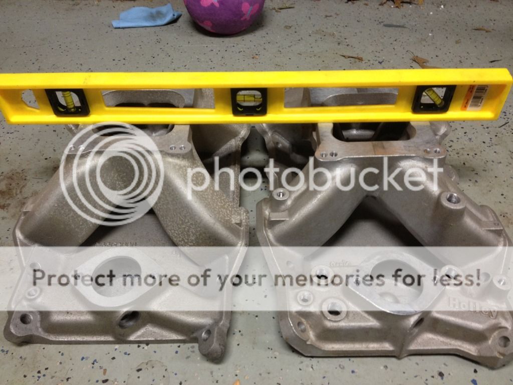

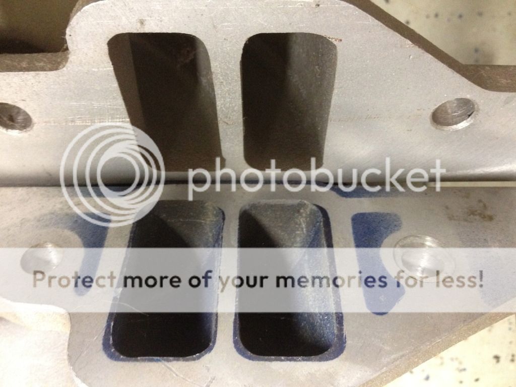

I currently have both of these intakes. The Strip Dominator is very marginally taller with a marginally larger plenum. Also the runners on the Holley are slightly larger.
I'll bet there isn't much difference between the two horsepower wise, but you never know...
Strip dominator has the blue around the ports.

Thanks ,for the pics,LX. Plenum taller,obviously.Looking,at the main plenum divider in back,tells me they slightly lengthened dividers,make up for the deeper plenum torquewise. Depends,what do you want to spend?
