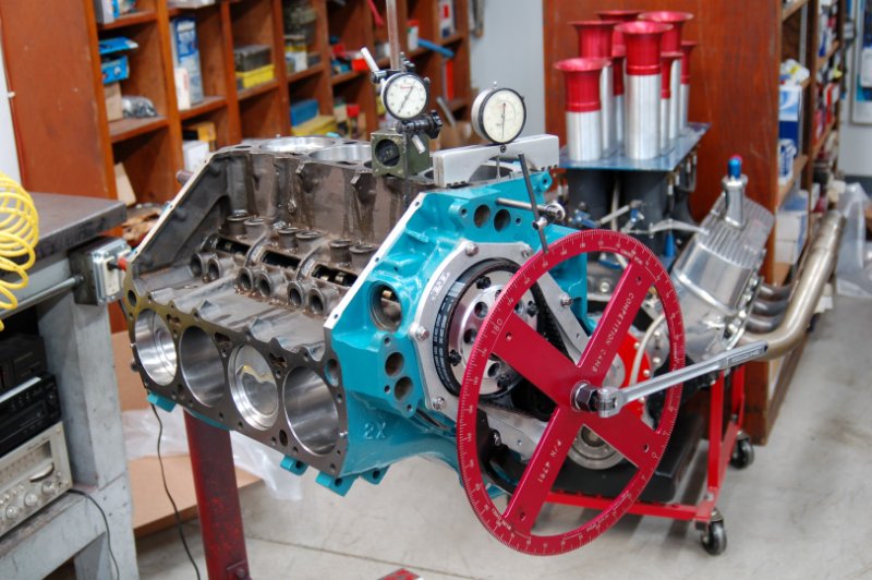

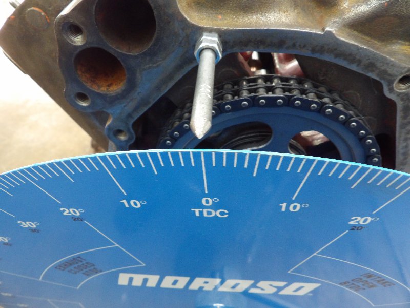

I made this from a 5/16" bolt cut to length and ground to a point. Threaded into the block and locked it into place and bent it up just a small amount to clear the timing wheel.
Work GREAT. NO movement at all like you get from a coat hanger wire...
