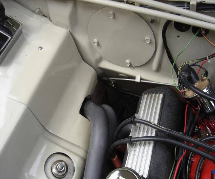

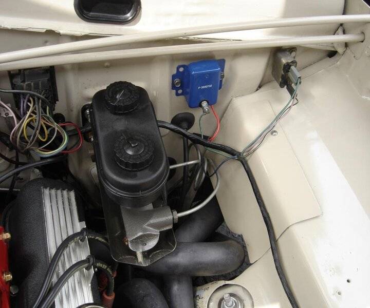

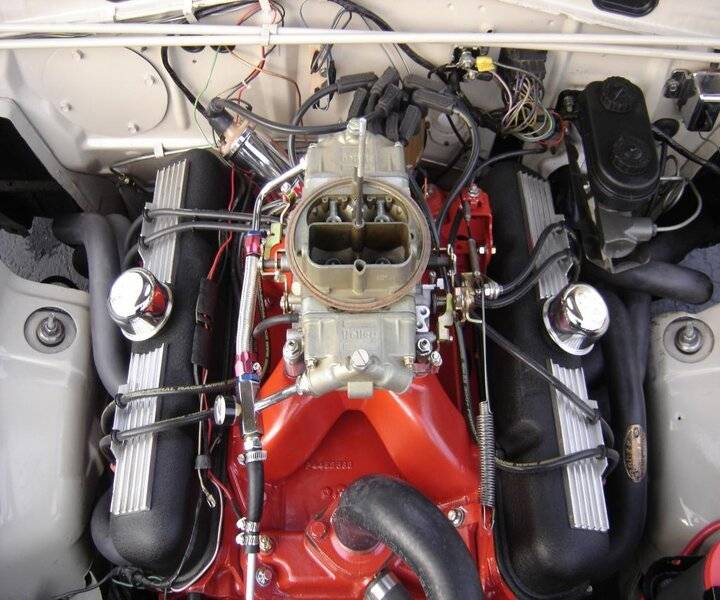

we did 2, one had the 4 sp/hack job big block fenderwells pictured and mine had the AT/pro-parts semi fenderwells that were modded to fit the narrow A. same B motor, much cleaner.
