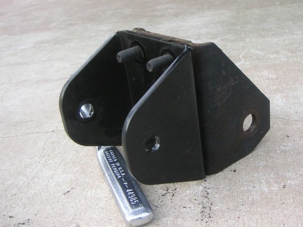

The Hotchkis rear springs with their "mid-eye" front and rear and the dropped front hanger will lower the rear end a lot. Most do not run the dropped front hanger.
Below: The Hotchkis front spring hangers is on the left. Notice the eye-bolt is raised up. It's about 1/2-3/4" up front the stock one on the right. I had it on, but it was way to low to make my car even front to rear with the TTI headers. BUT I run very small 24.5" diameter tires. A 26.5" diameter tire will raise the car 1".
Still, I would start with the stock front spring hanger. Then see if you want/can go lower. After your decision, check pinion angle like you should do after any leaf spring change.

This is the dropped front Hotchkis spring hanger being installed. I ran it for a while, but was too low for my short tires and TTI headers.
Thank you for this tip. We just install these using the stock front hanger and we love the stance.
