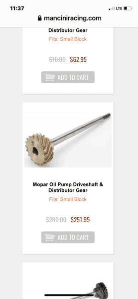

Why are oil pump drives so expensive ?
Seem crazy... almost as much as a custom roller cam !

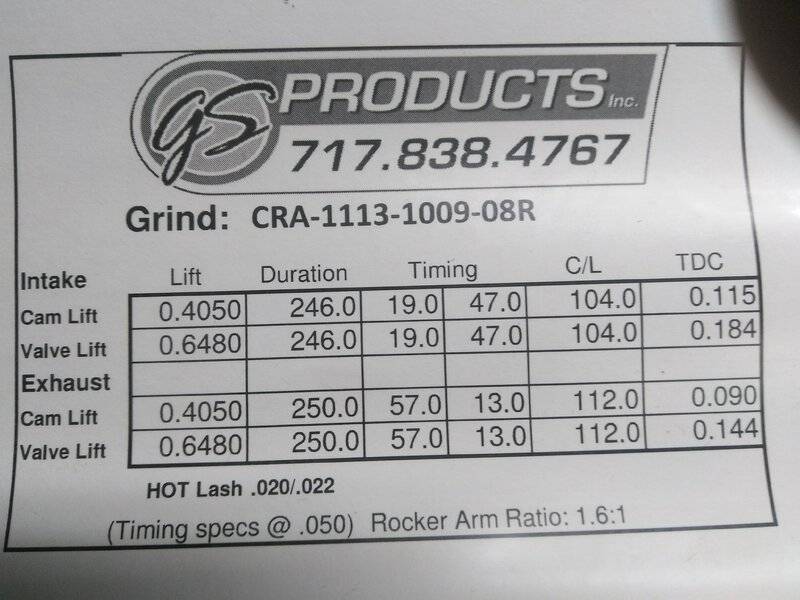

What cam blank did they use? Iron or steel? If its iron, you don't need the bronze. If its steel it was probably uber expensive to begin with and would have still been expensive as a regrind as the steel LA cores are all aftermarket.
Its a billet core .. I will post grind / blank when I get home . The current gear look a little wanky so I started researching .
