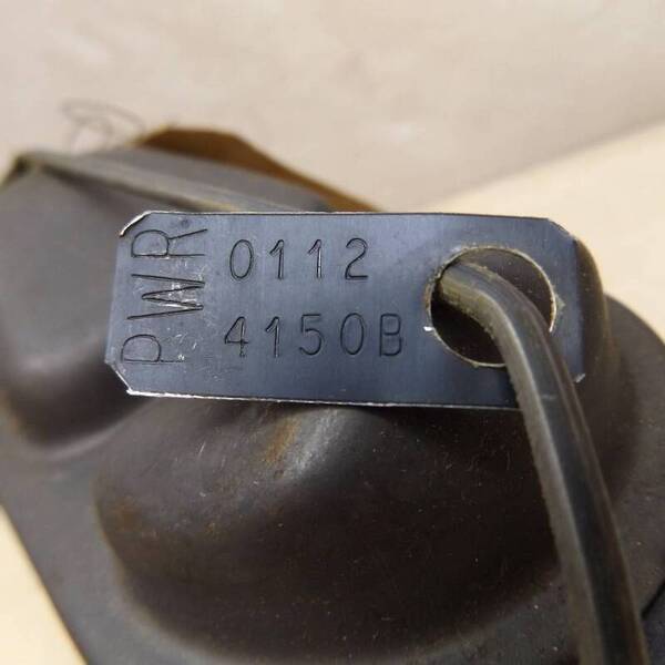

1975..Floating caliper, Power......____0357
1976?......................................____4647..........15/16
Not sure who is being asked for photos but here‘s a 75 master cylinder and booster.
Photos and discussion of original production A-body Master Cylinders
Example of a '74 358 0112 tag originally posted by @Dragon Slayer on moparts
For what it’s worth, attached is the tag on my 75 master cylinder.
