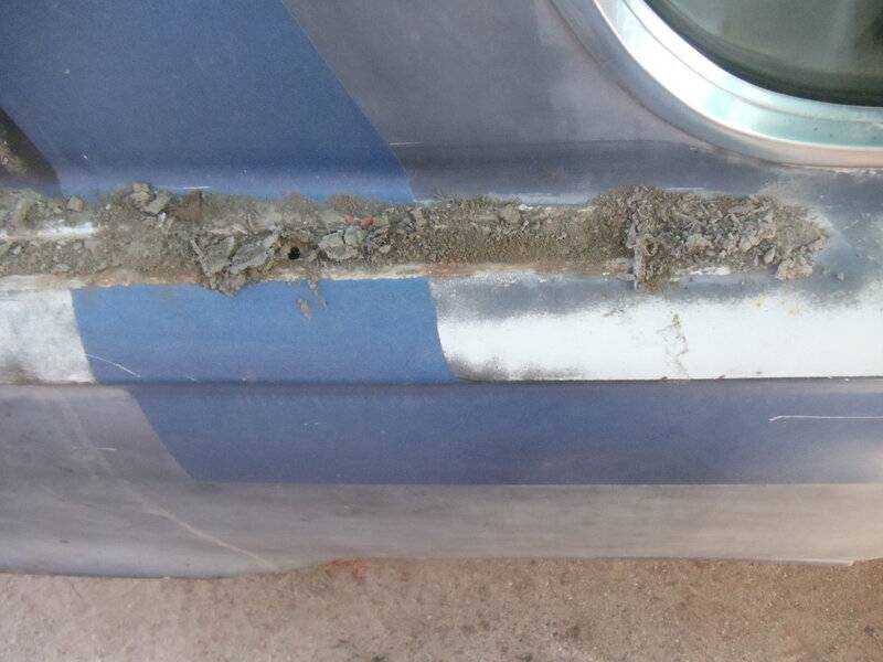

P.S When I remove the exterior moldings after having been placed 50 or so years prior, I find all kinds of dirt/gunk stuck under the moldings (see photo #3 of molding on '65 Barracuda quarter panel). When restoring, are these moldings just screwed or pushed back on or is there a filler/gasket/silicone used in the gap? Thanks again.
