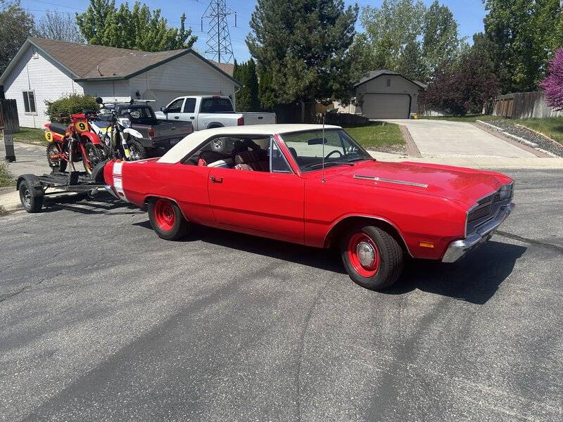

I have my 4sp Swinger with a 408 ,ported W2s and a solid roller for a ripper . Just looking for a mild mannered driver with a butt load of torque in the Barracuda.
Well given this, you already know what a torque monster a 408 is. So this new one will be all the more a torque monster with that smallish cam. Strokers eat duration for breakfast! It will incinerate the tires but run out of breath early. For the street, that should be fine.
In the avatar's 408, it's a 251/255@ 050 and I'd tell you I would add 10 more degrees at 050 if I did it again. But it idles "appropriately" (rough!) and has a 5000 stall TC, probably not what you're wanting in this 2nd 408 of yours.
(BTW...BEAUTIFUL car!! :thumbsup: )
Thanks ! The Dart has a 246/250 on a 108 with .648 lift . I can feel the pulses in 1st at lower rpms a little now ( more when towing my bike ! Lol ) and I do have a larger roller on the shelf but that would make the 4sp pretty jumpy off idle at prking lot speeds . Might throw it in to go racing just for fun but the car should run low 11s now and wouldn’t pass tech if I run mid 10s
