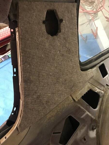

Yes they were glued in. The only screws are where the rear interior lights are fastened to the car. It does take a bit to get the wrinkles out of the headliner and I had to trim back the sail panels a bit to get the metal trim on.
When I get in I'll get some pics for you.

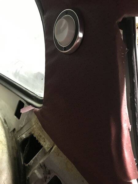

Here are the pics I took of my sail panels going in and the headliner. This is before I ran the hair dryer over the headliner to get the wrinkles out.

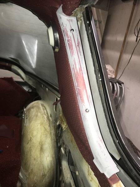

Here is a pic of the metal quarter window trim that must be fitted before you put the headliner in place. If not you’ll be trying to unglue the headliner with out ripping it to get some space for the metal trim. Ask how I know! I did that last week.

Fit and glue the cardboard sail panel first. Then fit the metal trim piece, And you'll find that the metal trim piece wont fit as it hits the thick part of the sail panel. Trim away the padded part of the sail panel so the trim piece can fit in snuggly and once the trim piece fits nicely remove it and now you can put the headliner in place. Now put the trim piece back on over the headliner.
Hope this makes sense.

I actually used a hair dryer not the heat gun. I was mostly 6 to 10 inches from the headliner and constantly moving it back and forth. I still have a few minimal wrinkles but it removed most or lessened them.
