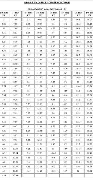

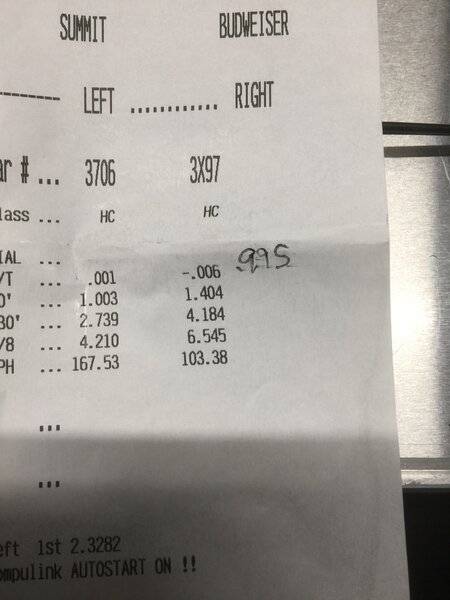

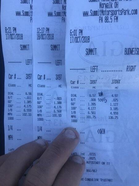

As most of you know by now I’m not much of a believer in dyno horsepower and have never used one. But my sons stock crank 360 was an engine that always impressed me for the parts used. We are limited to 1/8 mile times in our class at all the tracks we run at but his car has already turned nice 1/4 mile times, probably because of the 4.10 gears
engine combo
.030 flat top pistons in the hole as the deck was never squared or cut
Stock 360 crank.
Open chamber (340 style) ported Edelbrock heads.
Ported Victor340
.620 roller cam
750 alcohol carb
No vacuum, no special ring pak
chassis and drivetrain.
3200 pounds at the line
727 with 5600 stall converter.
4.10 (8 3/4 rearend)
Caltracks
car has gone 6.54 four or five times at two different tracks
any horsepower guesses because I sure as heck don’t know.

What calculator did you use?
A real engine dyno and a real dragstrip.
Calculations I’ve tried don’t work for me as I’m doing 11.44@114 in the 1/4 but I have a barn door to push through the air and the numbers given are bogus. I’ll never do any dyno (real or pretend) just real drag strips! :lol:
