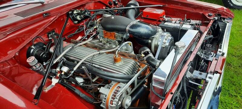

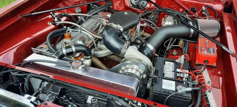

One option is to take a 318 and either a 4-speed OD auto or one of the many 4-speed manuals I have and drop that in place. However, I have a huge soft spot for slants, and that's what is in the car at the moment. I've been watching @rich_mc and his Torqstorm project, and I'm toying with that idea. I have a T-5 trans and the adapter plate to mate that up to a slant. The question is, what kind of HP and torque will the T-5 handle? I have no intention of building a fire breathing dragon, but a blown slant would be a real hoot, and a sleeper of epic proportions.

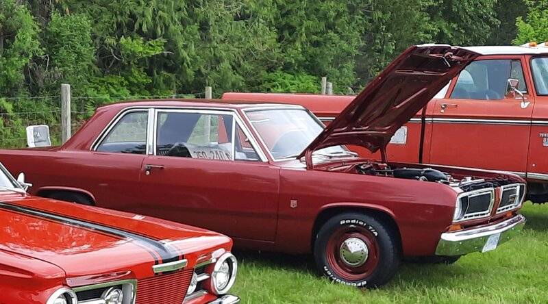

Just saw this at a car show....sweet!

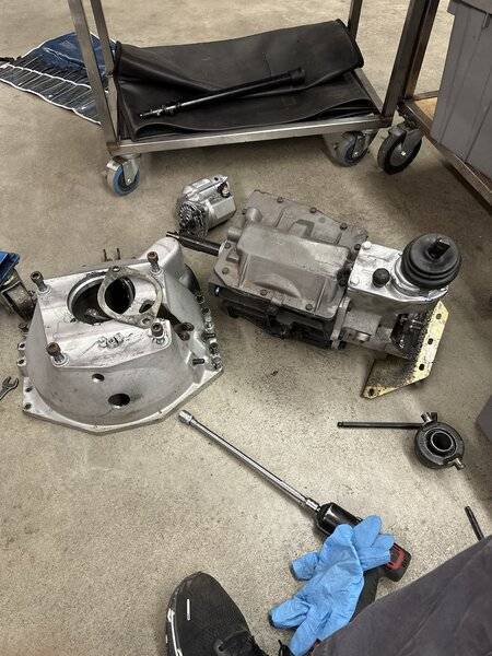

There is a Jag e type in my brothers shop, has the 4.2 with the world class that’s been modded to fit. The tank motor of the jag, killed 5th first and then 3rd. Ripped the teeth right off. We’re not sure what the power level was on that motor as it was new to us, the owner also managed to throw a rod out the side of the oil pan…

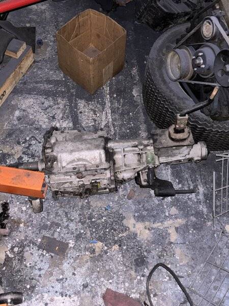

Well, I have one sitting all forlorn and feeling unloved, buried deep inside Parts Mountain.

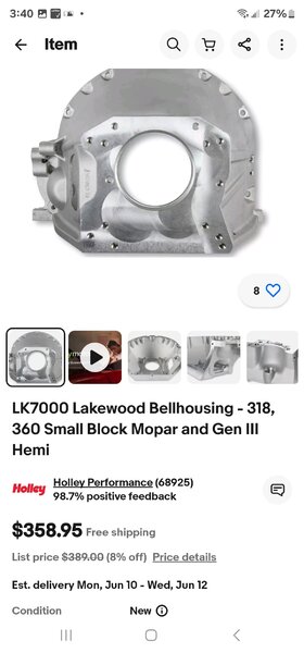

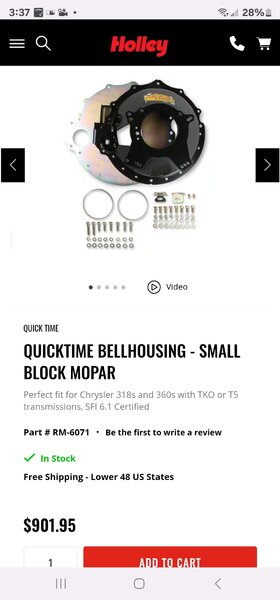

I've been wanting to try one for a while. I was seriously considering doing the swap in my dart until i saw the price of the sbm to t5 bell house prices. They are crazy expensive for a piece of stamped steel. Right out ridiculous imo! So I just stuck with the automatic. If I ever come across one cheap enough or in a junk yard I'm gonna buy it and see about making my own bellhousing. BTW the same bell house for a sbc is 1/3 of the price! Highway robbery!

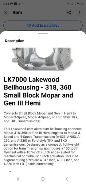

I just stumbled across this one after I posted this is a more reasonable option. But I don't see that it's spi certified. Not a big deal unless your racing

I think this is what @RustyRatRod 's using for his T-5, so he may have some first-hand experience with it.
