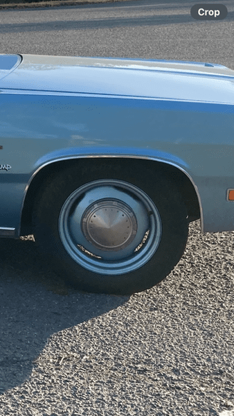

So I dont even own it yet and I'm already planning changes :D
The car has factory 15" steels, so I'm planning probably 225/60/15 as a step one, unless you tell me I can go bigger at the back?
I´m guessing the factory wheels are 15/7"?
There seems to be a fair amount of space between the wheel and fender at the moment.
Step two are new leaf springs with at least 2" lift as the back seems really low.
Superstock do seem a bit of a overkill for 318 with standart 7 1/4 rear, so is there tested middle ground for the springs lift?
Then lifting the front about an inch to give it some rake.

Factory wheels were 14 x 4.5 with a 4'' bolt circle unless it was a 340 or 383 then it would've been 14x5.5 with a 4'' bolt circle.
Oh, ok so obviously not a factory wheel then, thats a new one.
How about the rest of the plan? I do need to find out what the backspace is on these..
What are the tire sizes on the car now?
Correct, super stock leaf springs are not needed for the driving you’ll be doing plus your teeth will probably fall out (even if they are all currently real). Suggest getting XHD spring from ESPO or JRSpring. Shipping from North America will be steep but those are the springs you’ll want.
I had 245/60R14 on a 1970 Dart with no clearance issues.
I also had a pair of 235/60R15 drag radials on a set of custom made steelies, no clearance issues either.

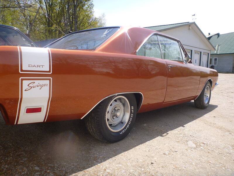

Yep, you need some rear springs, air shocks or add an extra leaf. The previous owner of my Swinger added a extra short leaf to the rear springs. It looks like it came off a truck. It did raise the rear but it does ride a little firm. I would recommend new springs and if you want some lift, they can be made with 1 or 2" extra lift. I run 15x7 wheels on the rear with 255/60-15's and 14x6's on the front to get the look I want.
That's perfect!
Beautiful car!!

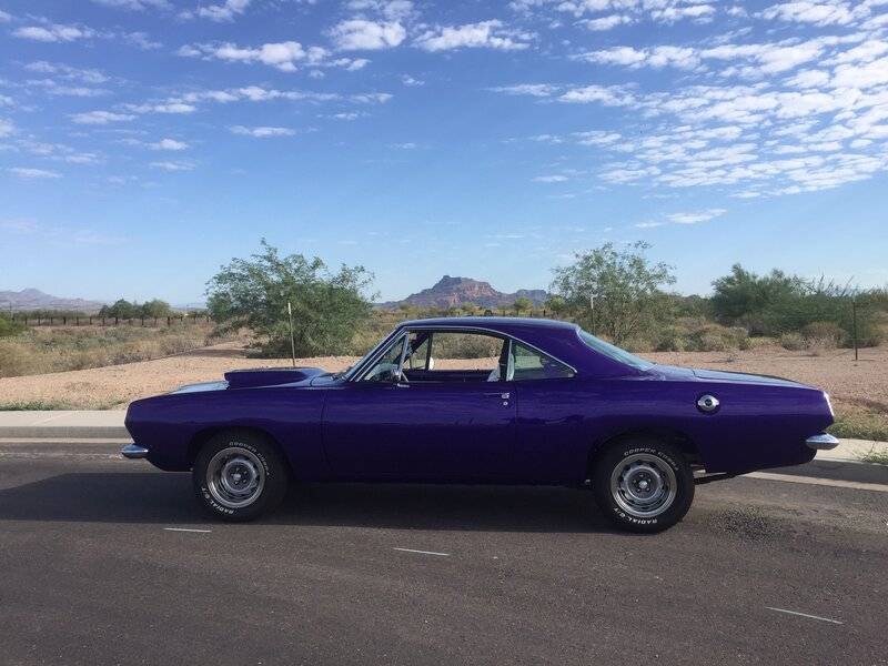

Looks great! Any side pn shot please? What size front tyre? Thanks
69 Barracuda, Firm Feel suspension front with .88 torsion bars, Eaton Detroit HD rear leaf springs. KYB Gas Adjust shocks and 15x7 Rallye wheels with 235-60/15 tires all around.
