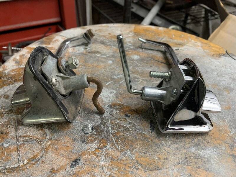

Unfortunately, our more-doors don’t get the same love and attention as their “sportier” 2-door counterparts. This is also true when it comes to the parts department. But when it comes to your exterior door handles it’s actually really easy to convert a set of new front door handles to fit your rear doors!

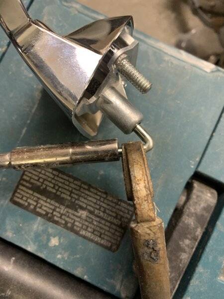

As you can see, the push ro on a rear door handle is different from the front. You start by turning the push rod upside down by removing the stud and screw on the back

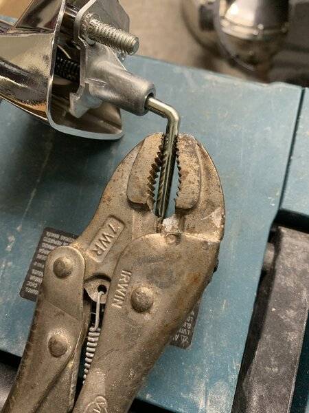

I used a vise grip to remove the stud

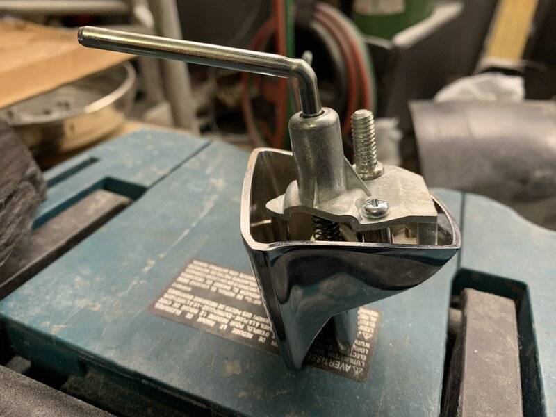

This is what it looks like flipped around

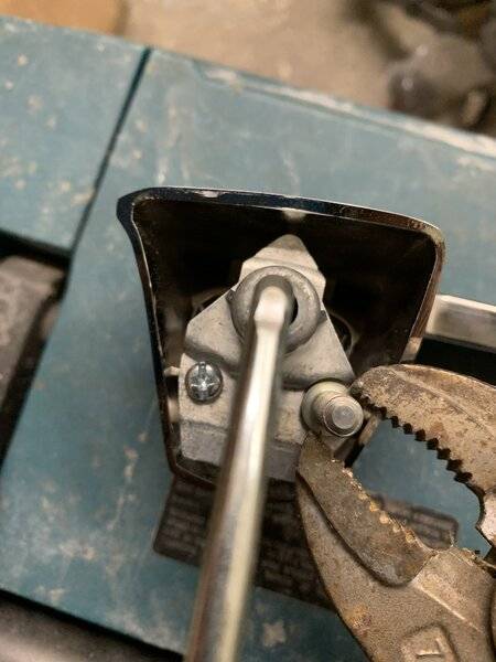

Next you have to bend the rod to match the shape that a rear door handle has
Bend until the vise grip bottoms out like this:

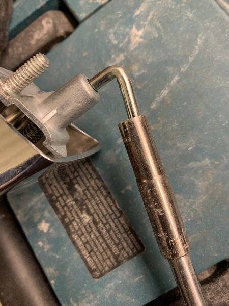

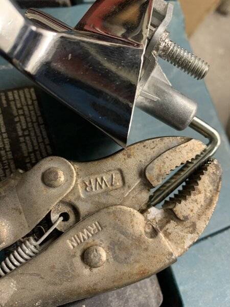

Then you can use a small deep-socket to bend it the rest of the way

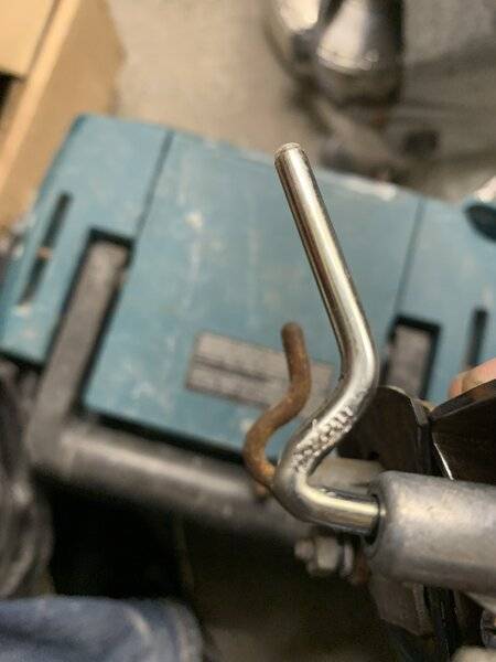

Now you have to bend it the other way; make sure your visegrip is TIGHT!
So when you reverse the shaft direction you are flipping the button over?
Or just rechrome your old button and install it in the new handle.

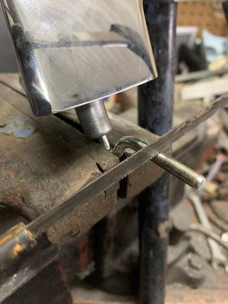

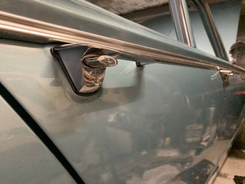

Thanks @ChrisRomello! Worked! Perhaps my rods weren't too long. I didn't have to cut at the end on my wagon as they came out great w/ just the bending after getting it flipped around. Basically adds maybe 10 mins to the install of rear door exterior handles.
